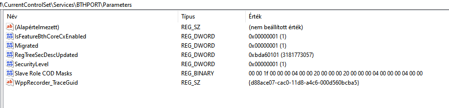

                Also, could you please send me a screenshot of this folder from Registry?:
                Code:
                HKEY_LOCAL_MACHINE\SYSTEM\CurrentControlSet\Services\BTHPORT\Parameters
                  Sure! Here is the screenshot of the mentioned folder:

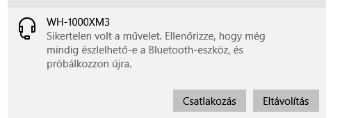

                        I uninstalled rewasd software but the problem still exists.
                        I tried 2 different BT headphone, both are pairing but if I want to connect to it sais "process unsuccesful, check if BT device is still present, try again". Both device are successfully connecting to my gf's laptop, so they are both functioning.
                        (sry its hungarian)
                        This problem is present since the rewasd made class change on the laptop's BT device.
                        Can it be reverted somehow? What can you see on the regedit folder I just posted recently?
