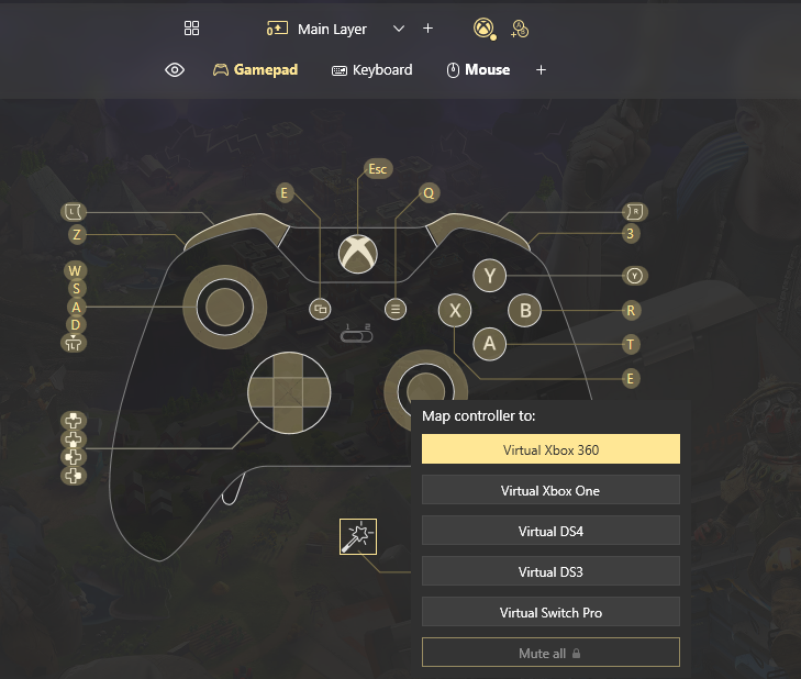

        We would recommend excluding virtual controller emulation in the config.
        You can do this by clicking on “Magic Wand”
        And then, you need Mute the buttons to which you have remapped keyboard keys.

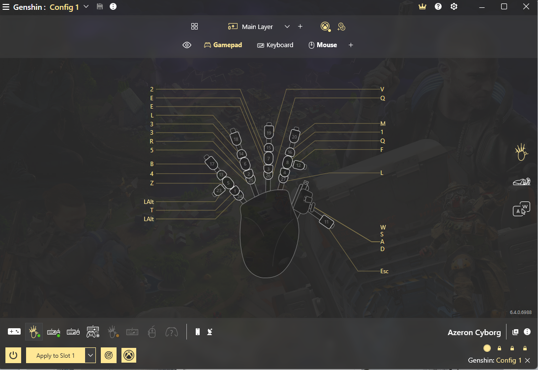

          Hi, now it's totaly confusing for me.
          When I go to configure the gamepad option, I only get the picture for my Azeron.I don't see (and have a controller). I never configured a (virtuel) controller myself.

          Now I can click on the magic wand and see:
          So, how to "excluding virtual controller emulation in the config" now ?

                1) reWASD shows a device that is currently selected. If the selected device or group of devices does not include a controller, the Xbox One would be shown on the [Gamepad] sub-config by default.
                2) This sounds like a drift issue. I suggest increasing deadzone value for Azeron sticks in advanced settings and see if that would help.

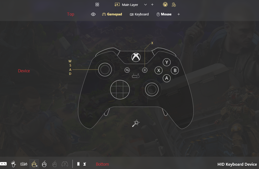

                      Ok, for me, it's confusing, how the top row corresponds to the Bottom row.
                      In my example, I have selected a mouse in Buttom row and "Gamepad" in Top row.
                      Also, I don't have a controller in my system, the picture of a controller with mappings is shown, that I never configured. The mappings seem to come form my Azeron, that I once configured.
                      1.) So, when I select a device at the Bottom, why can I select a Gamepad at the top ? What influence does it have, switching the devices at the Top,
                      2.) Why the picture of a controller is shown, also I don't have one ? When I switch to Keyboard in Top, no picture is shown, but a panel to add buttons.On Mouse a picture is shown, too.
                      That's inconsistent.

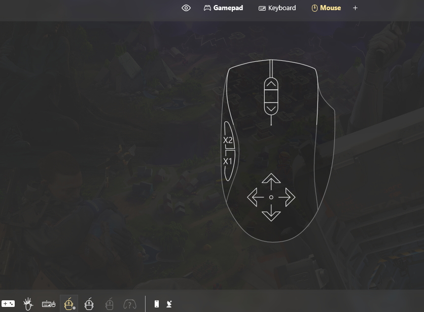

                      3.) Having this constellation (Top Mouse, Bottom a Mouse selected):

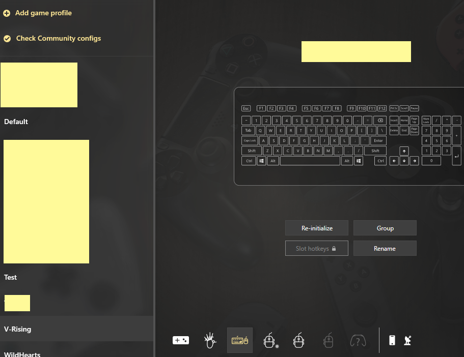

                      ​and I switch Bottom to Keyboard, it ends up in the Profile Select Screen:
                      Why? That doesn't happen, when I switch the Bottom to a Mouse device?

                          At the bottom, you select the device (or group of devices) to which the config will be applied.
                          The config can contain mappings for several devices at once, so a specific type of device is selected at the top.
                          You can also click the button to disable the config parts that cannot be used on the selected device.​
                          The controller tab is the Mapping tab in the config; Azeron is displayed there instead of the controller if the config is used for Azeron.
