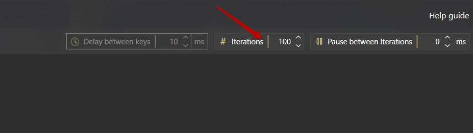

    The combo can be repeated as many times as you like. But it affects the combo as a whole.
    Therefore, it is not possible to obtain the result you specifically need now, unfortunately.​
