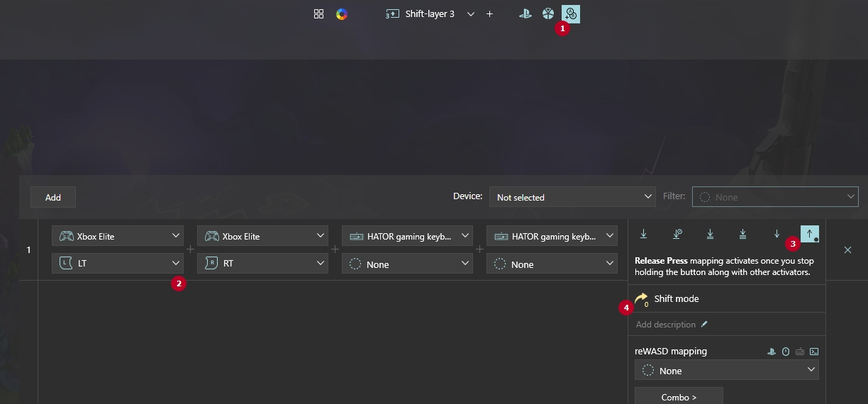

                          I have the same issue with a very similar setup (Also for FFXIV). Releasing RT and LT at the same time causes the layer to get stuck somewhere instead of being brought back to the main layer.
                          Is there any work around to reliably return to the main layer if RT = 0 and LT =0?
                            You can achieve this result by making a special shortcut and assigning a return to the main layer to the Release Press activator.
                              Thank you, this looks to be what I need. I have added this shortcut to all layers (except main) and from what I can tell it is working perfectly.
