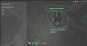

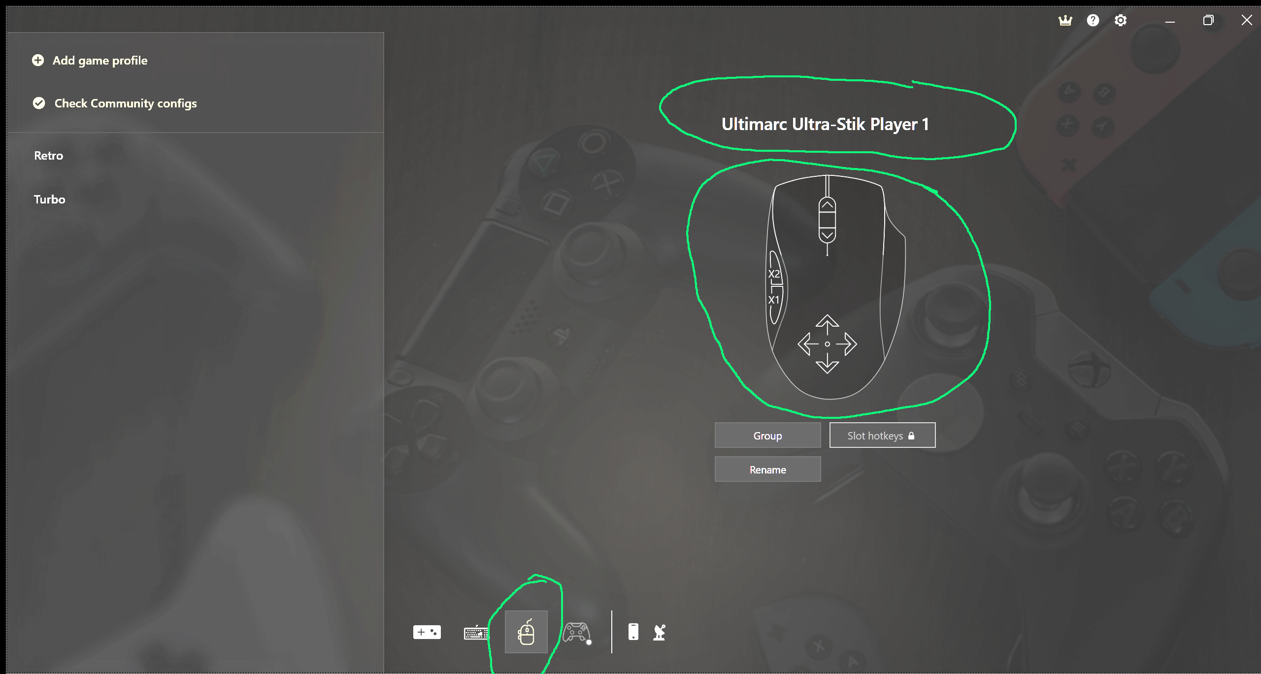

          Here is a screenshot from a fresh config.

          I cannot do further testing because in the time since I started this support request my advance mapping 3 day trial has expired. I have previously tested my config in the Gamepad Tester, which was just the U360 grouped with the X-Arcade buttons. The buttons worked in the tester, the joystick did not. If I test the raw U360 without REWASD at all, it does work in the Gamepad Tester.

            The screenshot also shows a keyboard and a controller. What are those?

              I'm guessing you guys probably need to support the "unsupported devices" that appear in REWASD when you plug in the U360. They show as a mouse and also an unsupported controller. The keyboard is the X-Arcade board. The controller is my Xbox controller.

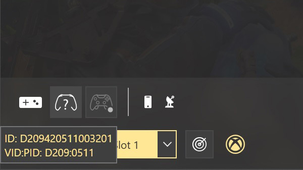

                        • What is the VID&PID of the U360 when it is set to work in analog stick mode (as an unsupported controller)? It is shown when you set the mouse pointer over the icon of a device.

                            I sent a revised log file (created after setting to analog mode) to the help email. Here is a screenshot of the VID.
