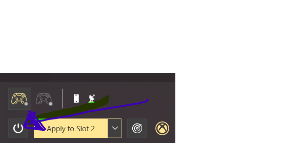

    When I try to press the "Power" button to turn on reWASD, nothing happens. No matter what I try, I can't get the application to activate and work like it used to
    ​Click image for larger version  Name:	image.png Views:	11 Size:	16.1 KB ID:	236178​
    "Power" button is used to re-apply previously applied configs.
    The update most likely removed that information, so you have to re-apply the configs manually to your devices at least once for the "Power" button to be available again.

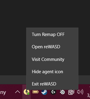

      Even when I right-click the system tray icon, sometimes it says "Turn Remap OFF" sometimes it says "Turn Remap ON" -- but regardless of what that text says, there is no remapping taking place. And if I try to click that menu option, nothing happens. If it said "OFF" it stays at "OFF" -- and the times it suddenly says "ON" and then I click it, it still says "ON

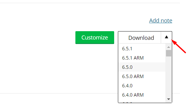

          Ideally, I would just like to re-download 6.2.1 and install that again because that was fine. But I can't seem to find a link to that version anywhere.
            Hello! Links to download previous versions are available in your personal account.
                Awesome, thank you sooo much!

                              This button is designed to enable remapping.
                              If the button is highlighted as inactive, it means that no config has been applied before.
                              Try to apply the config using the "Apply to slot" button manually.​
