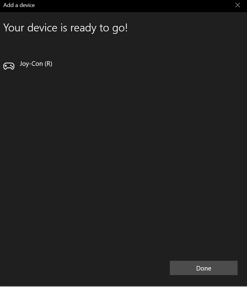

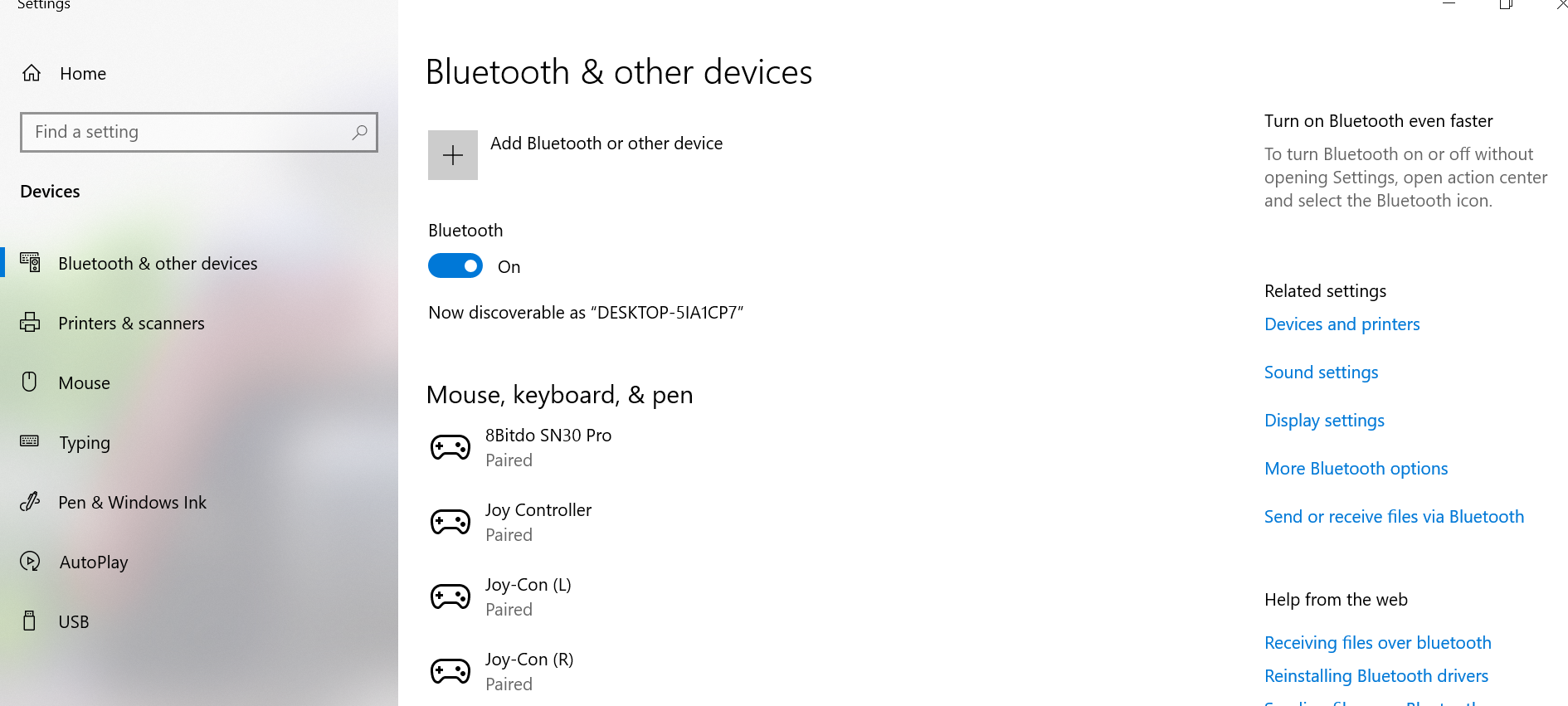

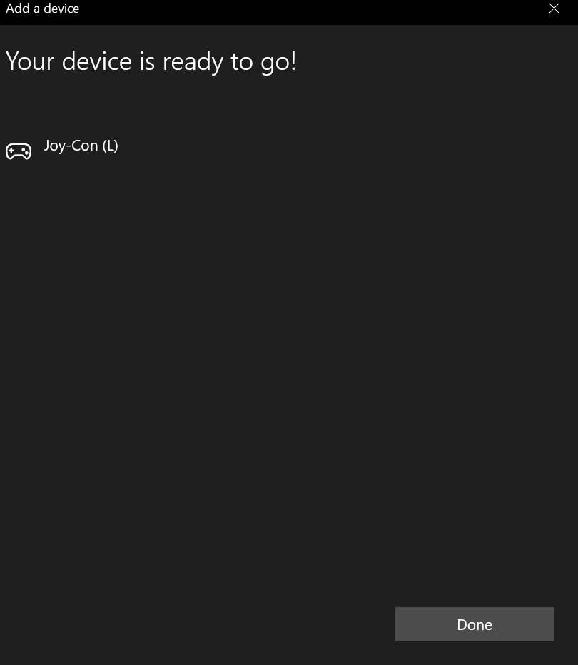

    • Paired Joy-Cons in Win 10 via bluetooth devices. In the bluetooth device list it shows up as Joy-Con (L), Joy-Con (R). (Attached Pic)

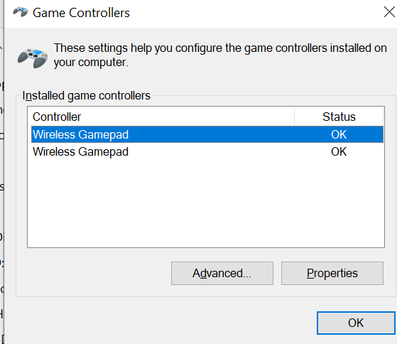

    • Looked in joy.cpl and controllers are showing up as Wireless Gamepad (Attached pic)
    • Able to view buttons and layout (Attached pic)

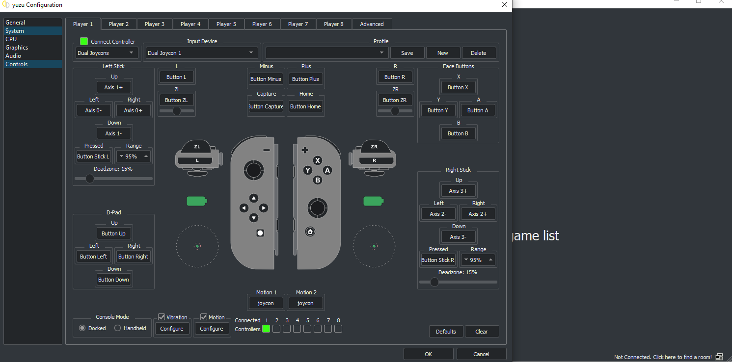

    • Was able to use programs like Dolphin / Yuzu to ensure controller is indeed registering. Buttons function, but had to remap using Dolphin / Yuzu as button configuration was weird (ie. Left -> Up, X->A, etc etc)
    • Nothing shows up in reWASD.
    So, it is weird that other programs are able to detect the joycons (with mixed up button layout that I had to remap), but reWASD is unable to detect at all.

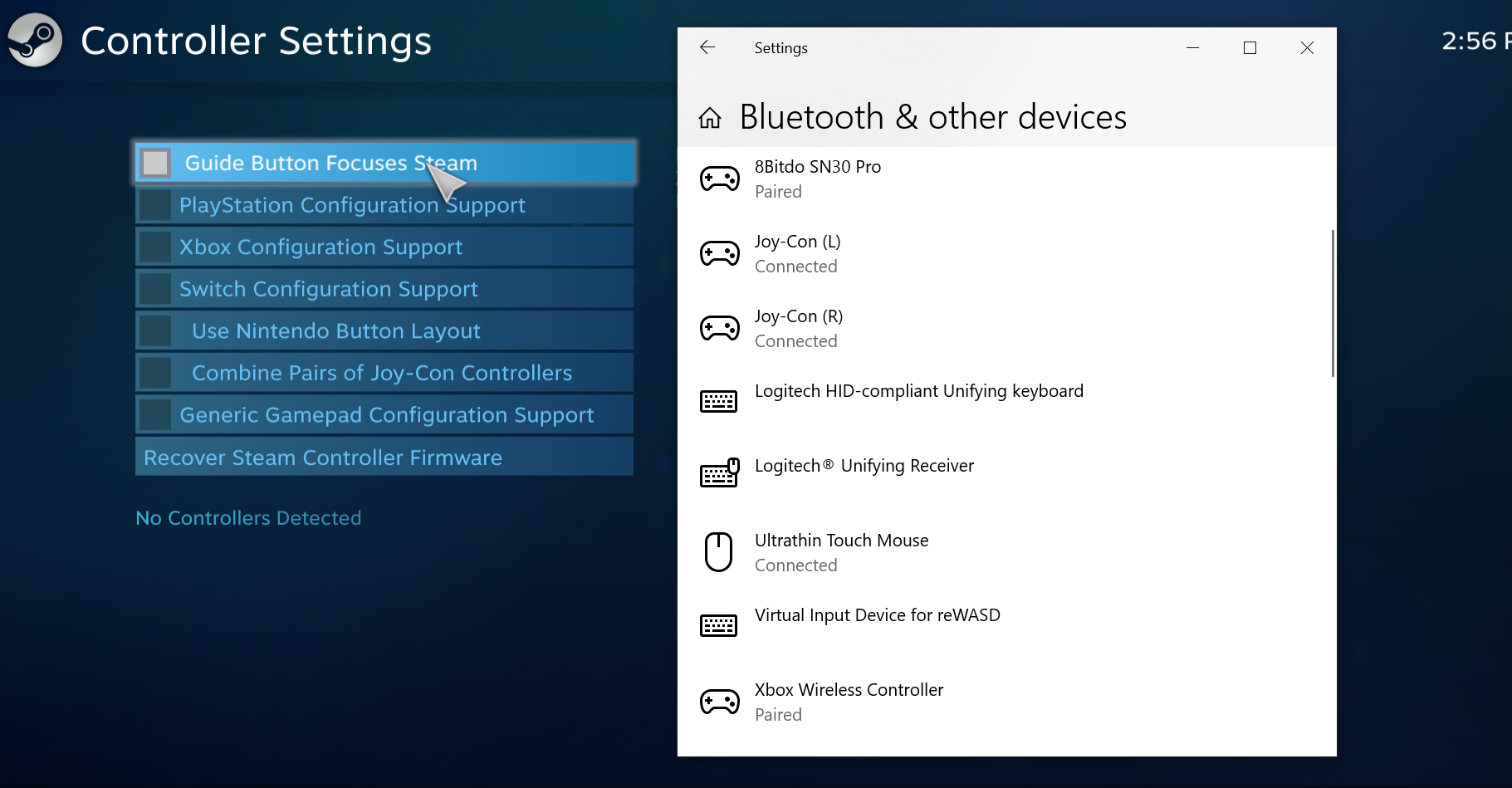

      Second, please show me how Steam sees your Joycon Controllers
      And finally, I'm wondering if you could provide me with where you purchased your joycons and these full name. Just these JoyCons do not return any info to reWASD according to log, and this is a reason why they are not detected
        Hi Miron4ik42. Thank you so much for getting back to me so quickly!
        So, for the Steam Input, it is weird, but they joy cons are not showing up in steam, even though Windows says they are connected in the bluetooth settings. Screenshot attached.

        The Joy Cons are 3rd party. NYXI Hyperion joycons (https://nyxigaming.com/products/nyxi...less-joy-pad-1). They work great on the Switch. And they can be seen in Yuzu (Screenshot attached). Just can't be seen by reWASD.
