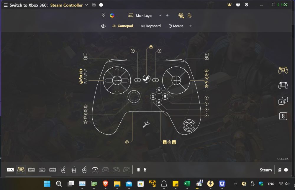

    Hi, I use 150% display scaling on my 1080p display. Since the UI re-design the whole window won't fit on screen without hiding the taskbar. The crucial apply profile button is at the bottom of the screen and is covered by the taskbar. The new UI oddly seems to have been designed for 4:3 aspect ratio with elements stacked vertically as there are acres of space for UI elements on either side of the window that could reduce the vertical height required. Can this be fixed as it wasn't an issue with earlier versions, thanks.

    Hello. We are aware of this issue, however at the moment 150% scaling may cause more other visual issues in the interface.
    For now, I can recommend using 125% scaling until we fix this issue.​
