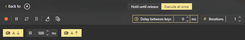

    It is possible to remap a button to a [Combo] of itself held for a specific time (can be set in the 2nd node) like this:

    But if the condition is to hold the button for a bit after it was released with no regard to how long it was held, the solution would be a bit more complex:
    • Remap the [Single Press] activator of the button to itself and enable the [Mute] flag for it.
    • Remap the [Release Press] activator to the [Combo] shown above.
      It worked. I tried the second option and totally worked.
