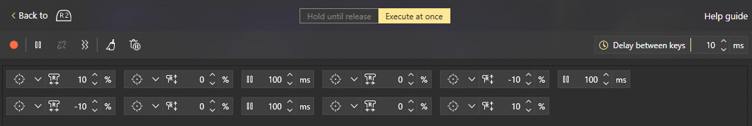

    If you mean screen shake, then you could try the Toggled "circle" combo. Basically, you would need a combo that mimics the square or a circle, so it would be something like this:

      Yea kinda but this doesnt work, This movement needs to be relative, What i want to replicate with rewasd is what the zen rotate the joystick constantly in circular motion this makes the aim assist stronger
        What exactly doesn't work for you?
        Please describe in more detail.
        Also, you can try to select Relative deflection for this combo.​
        Click image for larger version  Name:	image.png Views:	0 Size:	2.0 KB ID:	236549​
          When i press the combo it just jump to places but it does not always work, it only moves randomly, Im using it in Apex.
          Just to be more clear....
          I press the hotkey, it then jumps but wont go in a circle or square, when i press again it does nothing , after I press it a couple it then jumps again.

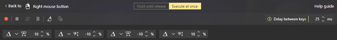

            Circular motion is not possible with reWASD at the moment due to the limitations of [Combo editor]. Square shape movement should be possible with this [Combo]:
            Make sure to enable the [Turbo] option for the mapping. Its value should be equal to [Delay between keys] used in the [Combo].
            Note: You will need [Combo], [Advanced Mapping], and [Rapid Fire] features for this to work.
              That helped me, thank you.
