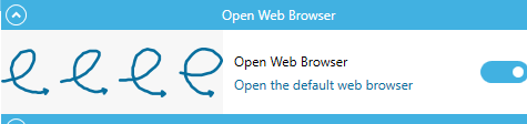

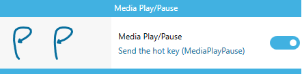

      Hi, so basically the program GestureSign allows me to create custom gesture shapes and add custom commands to that shapes. As shown in the first picture below, a gesture in the form of the letter "e" with 4 fingers opens up the web browser. In picture 2 the gesture in the form of the letter "p" with 2 fingers allows me to press Play/Pause.

ID:	236925Click image for larger version
      I hope this explains it a bit better
