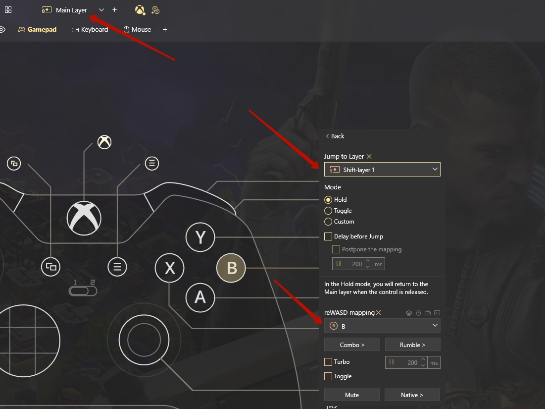

    Playing DMCV. When I play as Nero, I hold down the trigger for enemy lock on. Sometimes I want to use the arm ability, set to B, without thinking about whether I'm holding down lock-on or not.
    Is there a way to set B to release RT?
    There is one way to achieve button release by pressing another.
    To do this, you need Shift mode.
    On the main layer, set B to jump to layer 1 in Hold mode.

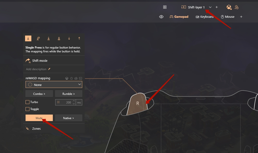

    Then in layer 1 apply Mute to RT.
    Thus, when you go to layer 1 by pressing B, the RT input will be interrupted.​
      This is definitely the answer, however, it's a little inconsistent. Playing in the void shows the controller inputs and it does show RT releasing, but sometimes the hook still comes out as if RT is being held down. IDK if there some way to delay the default B input a little so that the RT input has for sure become muted
        I'm not sure that I ideally understood your request.
        When switching layers, the RT input should break immediately. You can check it out on the gamepad tester.​
