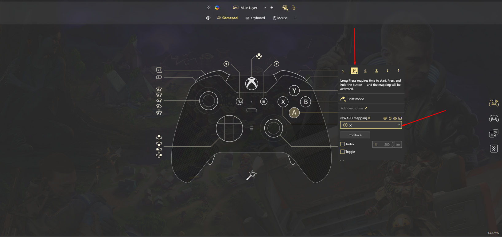

    If I got you correctly, you need to add X button on Long press Activator. So, while you hold A button, X button starts pressing.
    If you just tap on A, the ​character take cover function should stay.

        What Miron4ik42 advised you works according to your request. You can test it on the tester.

              Hi, i just tested it on the tester, when I hold A it shows that I'm holding in X, but when I tap A, it either taps as A and sometimes X
              I have to tap A really quickly for it to show as tapping A button, but like a regular tap shows it as pressing X
                It looks like Mapping X on the Long Press Activator works faster than you need. Try increasing the value of the Long Press Time parameter in → Press Time.
                  True, but I need that to be fast in order to make my character run ASAP to avoid grenades etc and have a quicker reaction in general.
