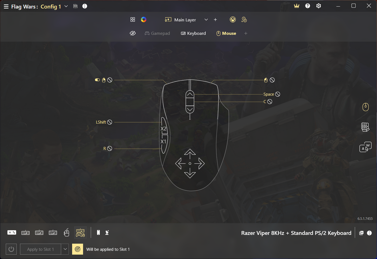

    Please send us a screenshot of the full reWASD window with your mappings.
    Also, please send a screenshot of what your device group looks like.
      hi,
      yes i am using autodetect for the roblox config. i also have reWASD enabled on startup. i havent changed anything from when it was working. roblox did a new update that added Hyperion protected 64 bit client. not sure if this would cause any issues with reWASD but roblox updates are automatic and unavoidable.

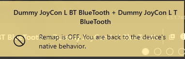

                      Do I understand correctly that it doesn't work even if you manually click apply? So, you click apply, then run Roblox, and the config just turned off with a similar message?
                        yes exactly. or if i autodetect it will launch the config and that box will show that it has been launched and then almost immediately it will show that "Remap is off" message.
