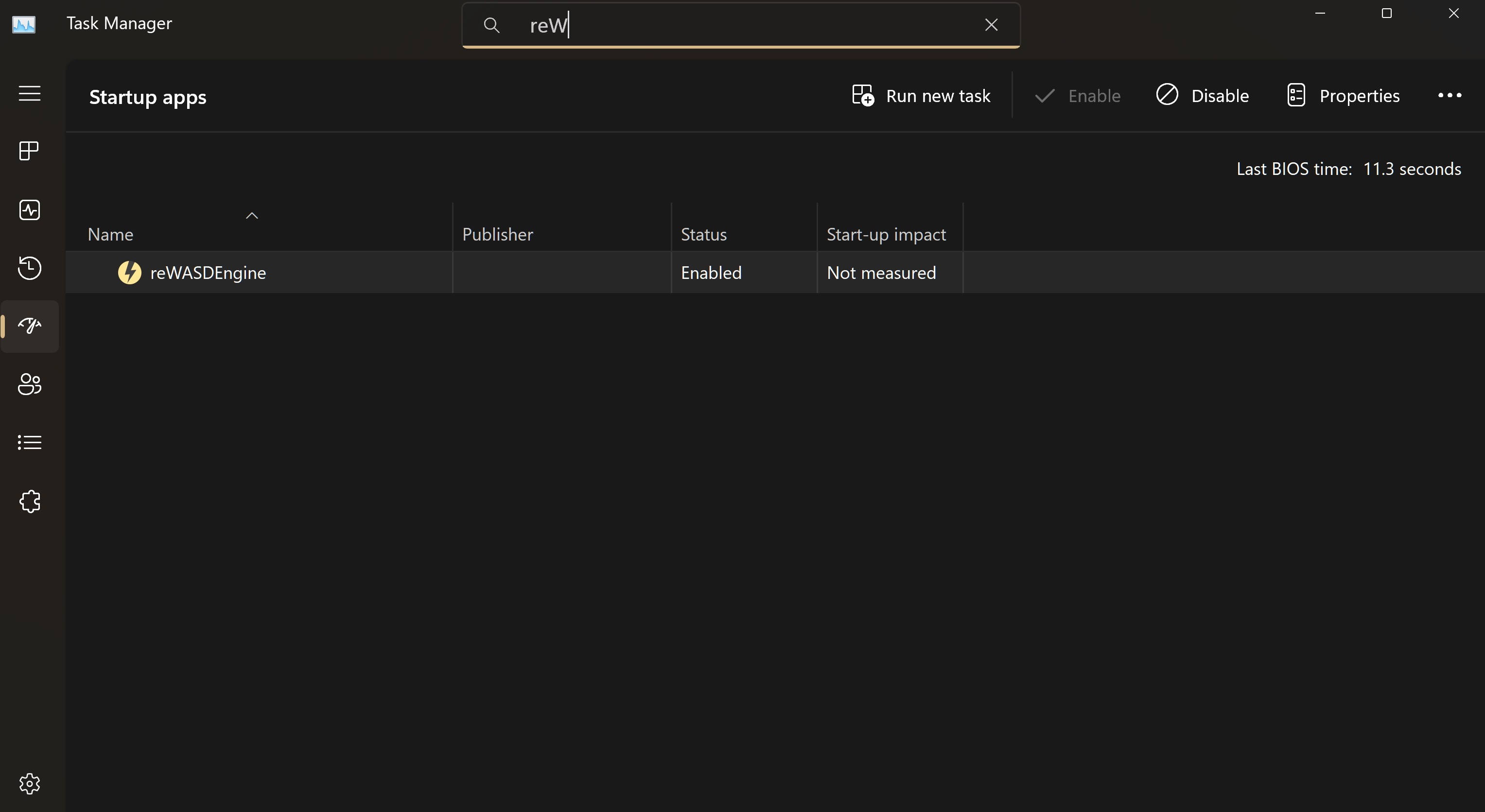

    I have set reWASD to startup automatically with Windows (as it is by default after installation) however the reWASD app does not actually start with windows and it does not show up in the system tray untill I start it manually. After I restart I check and notice in the Windows start-up apps the reWASD app is unselected even though I had it selected to start with Windows ?
    Is there a reason for this ? I have whitelisted the various apps in the virus checker as this was at one point causing a problem with executing reWASD, but not it does start manually no problems ...

    Perhaps autorun reWASD is disabled in Task Manager?
    Send us a screenshot of your Startup tab in Task Manager, please.​

      here's the task manager
        Please make sure that these options are enabled at [Preferences > Tray agent]:
        • Autostart the background agent
        • Restore remap state on startup and device reconnect
        Then verify that Tray Agent starts after Windows restart (it would not autostart if you unlock or wake up your PC from sleep/hibernation mode).

          Hi, I've checked the settings and they have been switched on by default since installation.
          Also on Windows start the start-up for reWASD seems to be switched off even though it was on before shut-down. It seems to keep doing this everytime and there is no reWASD in the system-tray at Windows start. I'm running Windows 11 home with all the latest updates etc. and a Bitdefender anitvirus and internet security app.

            Hi again, so afterall, I simply uninstalled the reWASD app completely, and re-installed it with the antivirus temporarily switched off. I reapplied the backed up config files etc and switched the antivirus back on. It now seems to be working as intended with Windows booot and the system-tray icon starting up as intened. Probably should have tried that first ...
