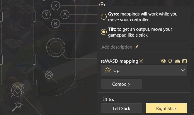

    I'm not able to figure out how to use yaw instead of roll for gyro tilt mode. I changed the default axis in the config and it works as expected for gyro mode, but when I switch to tilt, it uses roll no matter what. I tried assigning a button to the "invert axis" command but that doesn't work either.

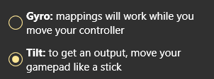

      thanks for the answer. Unless I missed something this affected only the "gyro" mode, not the "tilt" mode. I want to use yaw axis when using "tilt" mode of the gyro controls
