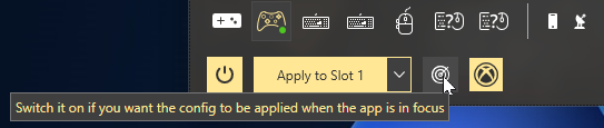

    Trial-ing reWASD but struggling to use it. I guess I don't understand the basic configuration. I have a working Xbox 360 controller with Project64, and wanted to add a "swim fast" by mapping Y button to a cycled A button, but even with mapping nothing, there's no controller response at all within Project64 if reWASD is on. I'm not understanding all the terminology, either. Is there a way to have reWASD still make the controller work "as is" and then I can try to tweak more buttons? Project64 works fine with my controller, I just wanted to map unused buttons to something useful.

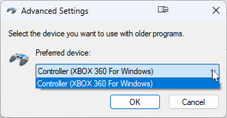

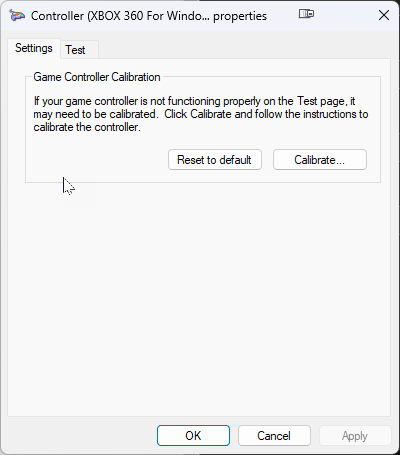

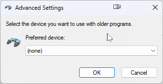

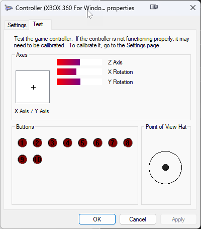

    Please send screenshots of how your controller is displayed in reWASD and joy.cpl.

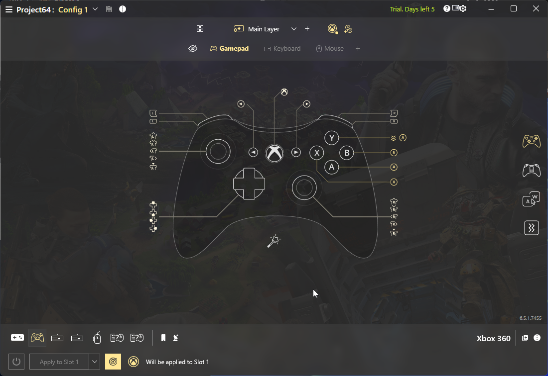

    Also, please send a screenshot of the full reWASD window with your controller mappings.
      Thank you, sorry I haven't responded sooner. I'm hoping this is what you're asking for:

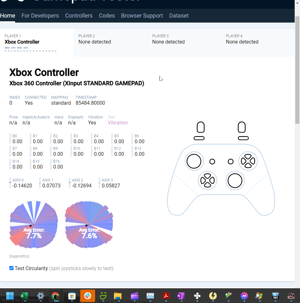

          Is this what you're looking for?

            1. Judging by the screenshots from the tester, you did not manually apply the reWASD config. Turn off Autodetect and apply the config using the "Apply to slot" button. Does the virtual controller respond to your button presses on the site?
            2. Please send another general screenshot from joy.cpl showing how many controllers the system detects. (The reWASD config must be applied at this point)

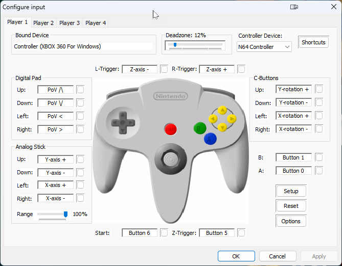

              This is what project 64 (v4) shows (it just works):

              I turned off autodetect (assuming this is what you mean since I don't see a name, just help text):

              After hitting Apply to Slot1 I didn't see any new controller show up in joy.cpl, even after reloading it:

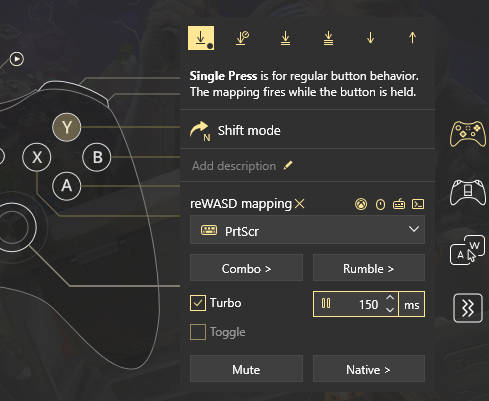

              It took me quite a few tries to realize I needed to press all buttons at the same time. Sure enough, it flickers A when I hit Y (will need to tweak the speed of course), and all other buttons just work. This is the mapping in the config:

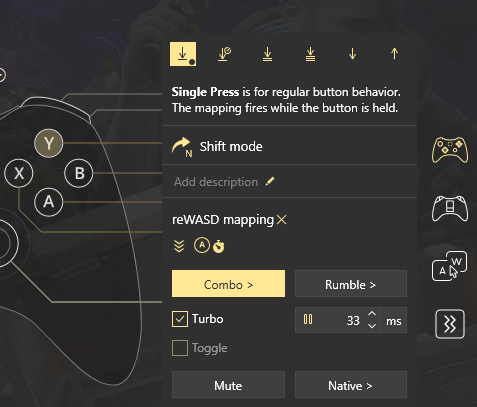

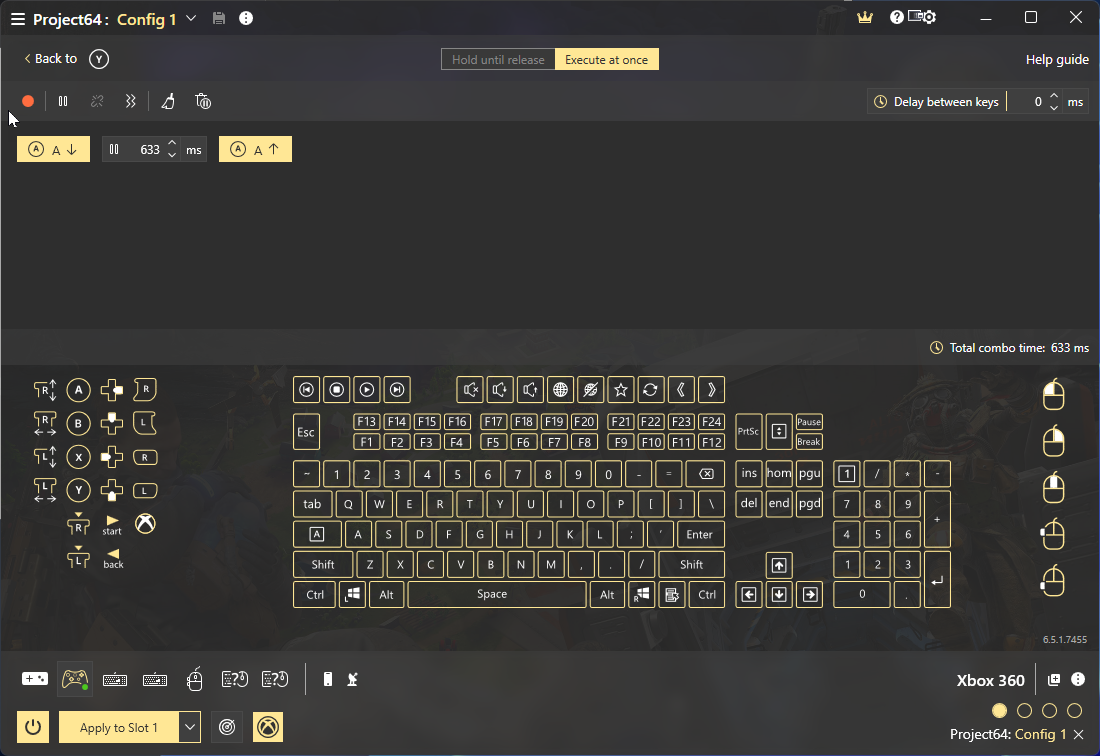

                I got "fastest" fast swim working too. There's a combo of down and up that matters and I was able to achieve it using combo and turbo at the same time. Combo delay from down to up of 633ms and turbo repeat of 33ms (this gets pretty close to ideal 90bpm or 667ms total round trip.
