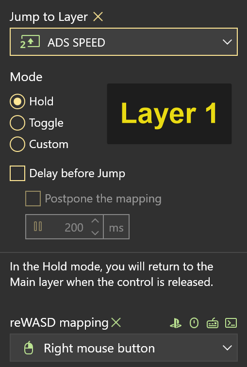

            Image #1: Shift Mode back and forth between Layer 1 and Layer 2

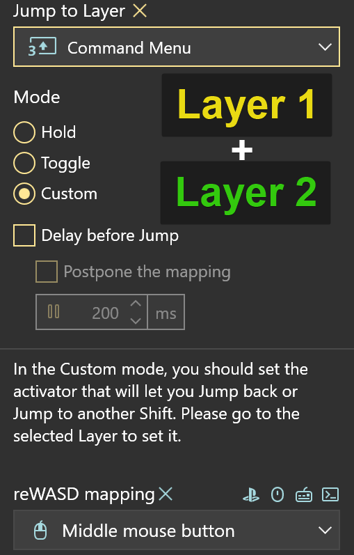

            Image #2: Shift mode to Layer 3 from Layer 1. Duplicated settings for Layer 2.
            *Note that 'Custom Mode' has to be selected because 'Hold Mode' to target Layer 3 cannot be used from both Layer 1 and Layer 2 simultaneously.*

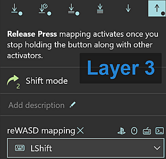

            Image #3: Current use of Shift Mode from Layer 3 back to Layer 2.
            When I 'Release Press' the Shift Mode Activator on Layer 3, it will revert to Layer 2 without issue, while aiming. This keeps Gyro On and aiming sensitivity lower, which is exactly what I want it to do while I am aiming. However, if I am NOT holding ADS button when exiting Layer 3, the only option is to still get stuck inside Layer 2. Even though Gyro is tied to ADS button, and therefore only gets activated when I want it to (during ADS), I end up getting stuck with the slower aiming sensitivity from Layer 2 until I tap ADS button again; so that it knows to shift back to Layer 1.
