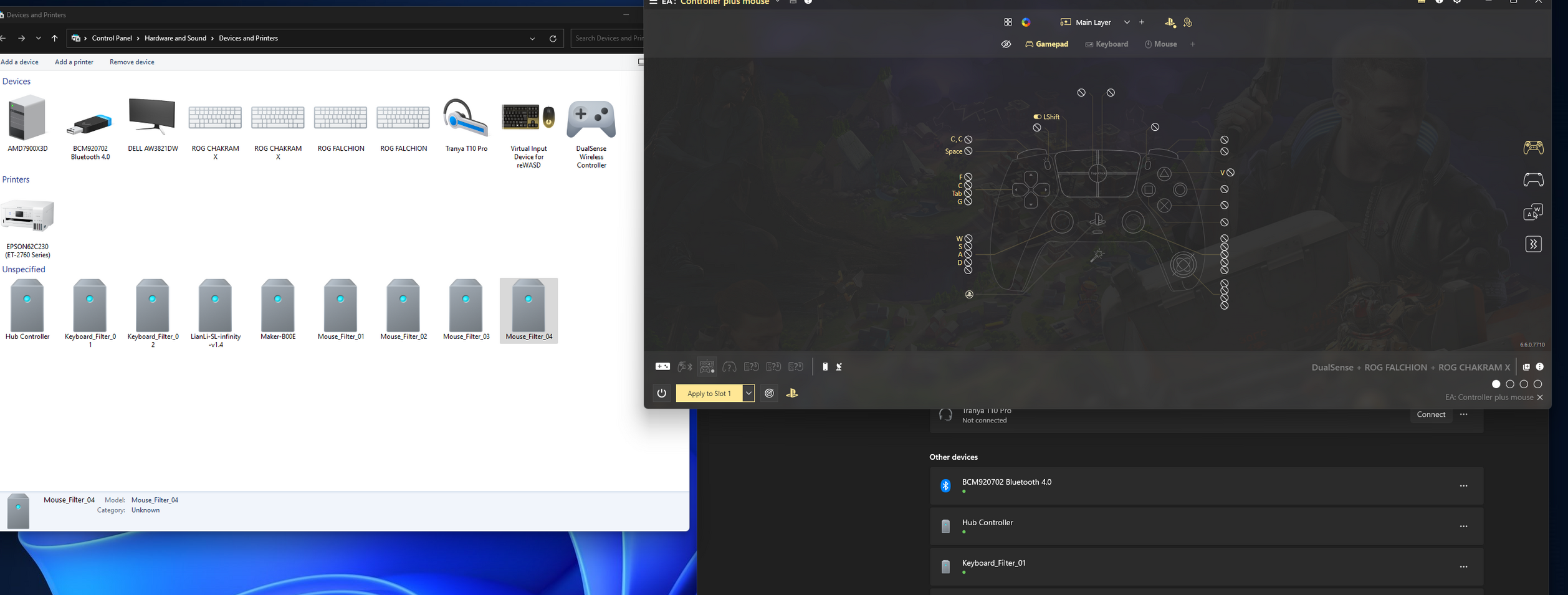

                Okay, I have had problems every night I have tried to play with Rewasd and I figured out a little. I have had to mess with this more than I have played. But anyway sometimes it starts working but I’m not sure why after I mess with it for a few hours but nothing repeatable. Usually the PS5 controller connects and the blue lights just go out like it goes to sleep and the controller is unresponsive no matter what I do until I either hold the PS button down until it shuts off or I disconnect in Windows 11.
                However, if I stop the Rewasd Game Controller Mapping Service the controller connects fine with the white led showing up in game and I can use the standard controls in games. I can not use with Rewasd even if I restart the controller mapping service one I connect this way though.
                  Please run reWASD, then plug up your controller and show me how it shows in reWASD GUI
                    Had it working the last few days but didnt restart the PC. After restart its back to the same.

                          Just another update but…. Even if the controller appears to turn off and it wasn’t showing in the joy.cpl screen….it still it is connected in Bluetooth devices screen. I was still able to use the controller in game with my reWasd load out tonight…..even when reWasd doesn’t show it connected, or vibrate the controller when you click on the controller like normal. It seems to load the virtual controller configuration and I can use it without every thing else being responsive like the lights on the controller going out or rewasd showing my controller. IDK but if it works it works. 🤷🏼‍♂️
                            It is more likely that something on your PC is preventing the controller from working properly on your PC
                              The controller works fine after reWasd is uninstalled. But I don’t want to play that way since I want the mouse controls with wasd movement. I sent Strokel the link to the NFO file in a private message is that okay or should I post it here? Most of my hardware is the latest so maybe there is a conflict there. Also reWasd became unresponsive with my keyboard and mouse so I had to reinstall reWasd again.
