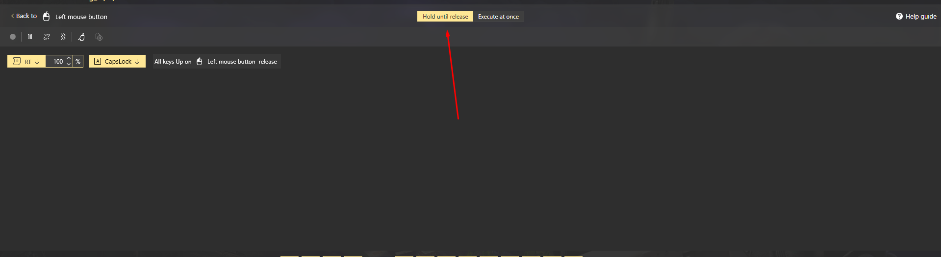

    Hello. I have the following doubt about the solution of this "problem". I made a combo on the Left mouse button, it activates R2 and Capslock (pressing combo). Until then everything ok.
    My question is whether I can create a combo or modify this one so that when I release the left mouse button, Capslock also turns off. Today I press the combo and it just activates. It would be possible?​
    If I got you correctly, all you need to do is to change the combo mode to Hold until release​
      So my combo is like this, but when I press it activates. I would need to do one that he activated the capslock and when I released the Combo he deactivated the capslock.

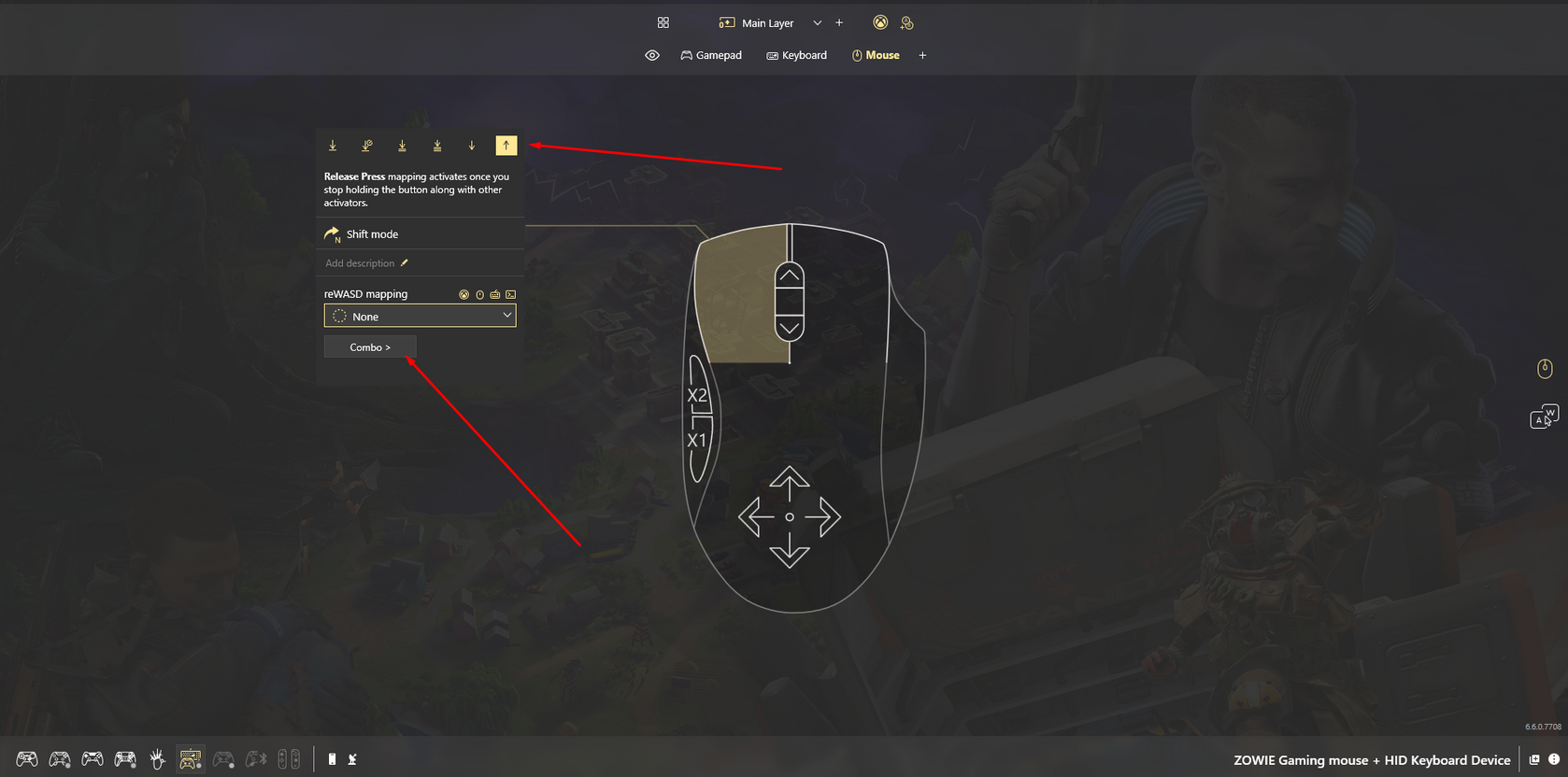

        In this case, try to add the combo to Release press activator
          Great idea, I did it and it worked. Thanks a lot for the support.
