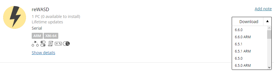

    About old versions
    All reWASD old versions can be found in your personal account here:
