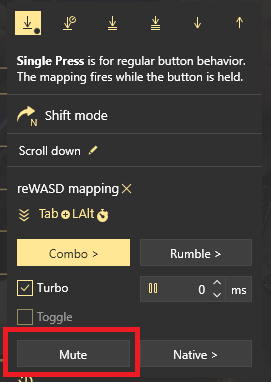

          I tried that somehow i managed to do it the way you said it but itost me at least 15 fps in game idk if its normal or maybe i messed uo something
            Maybe double input causing fps loss. Could you check whether you muted native input in your config?
            This thing:
            ​ Click image for larger version  Name:	image.png Views:	0 Size:	20.4 KB ID:	237600
              So i have to mute every single native input on my keyboard and on my mouse?
                Yes, please.

                    Probably, I can suggest something.
                      This thing:
                      It worked thanks for the help

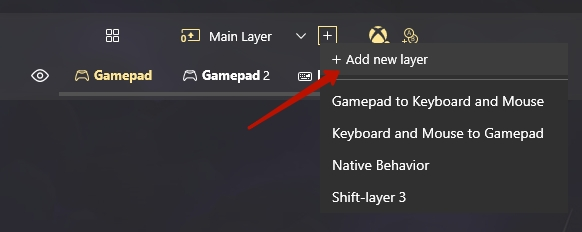

                        i just cannot figure it out how to add another layer without interfering with my setup if someone could help me on discord would appreciate that a lot
                          You just need to add a new layer:
                          By default, it will inherit all mappings from the main layer.
                          After that, in the main layer, assign a button for jump to shift that is convenient for you.
                          Then in this new Shift layer make a more aggressive (faster) response curve in Advanced mouse settings.
                          Apply config. When flying with a parachute, press the button to jump into this layer. Done.​
