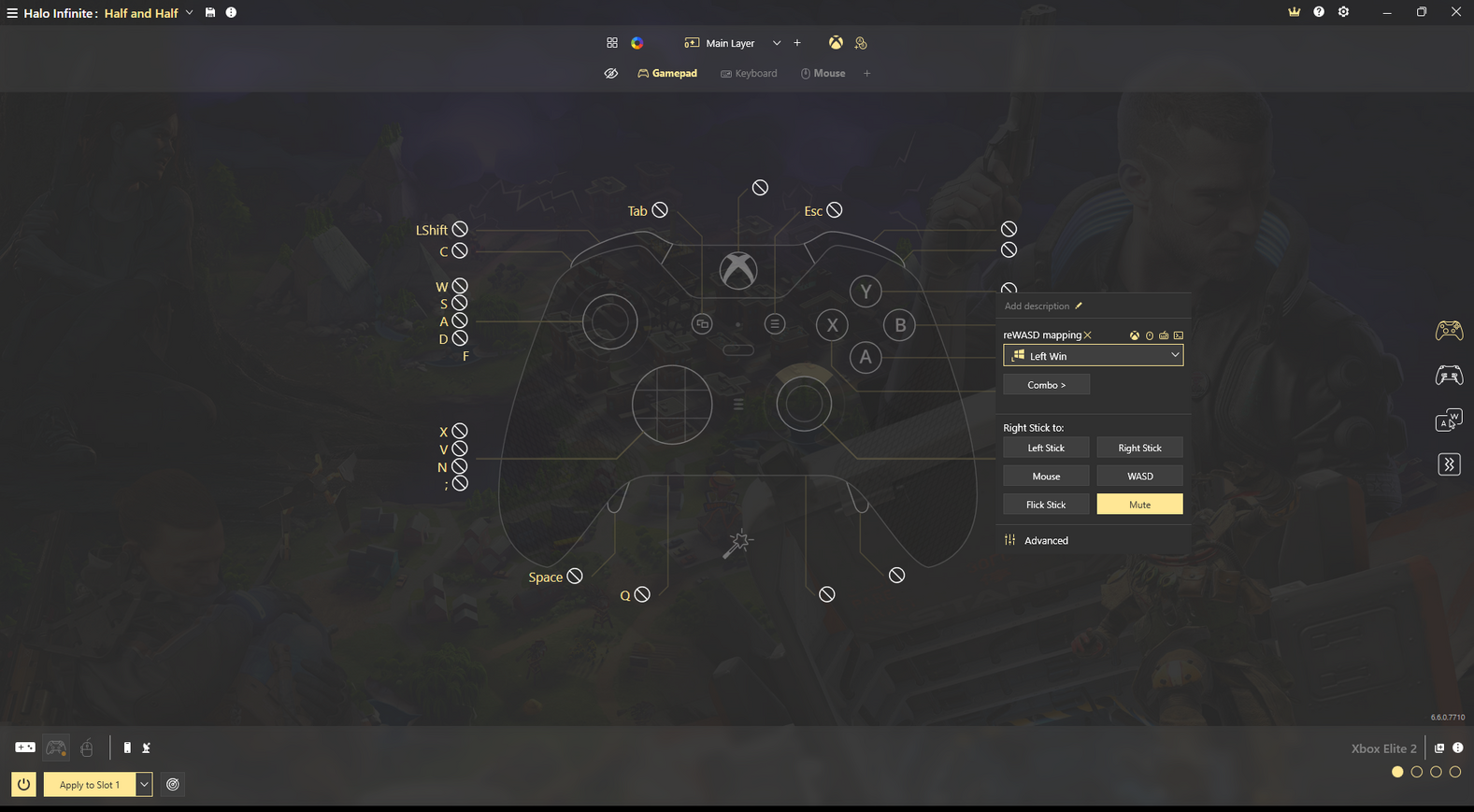

    So the issue that im having at the moment is that wasd on my left stick is causeing a lot of moments where my input will suddenly get "stuck" on a direction.
    This is very bad for moments where i will flick my left stick in one direction then let go and allow the analog stick to go back to neutral. This usually results in my player to move in the opposite direction of where i flicked to. Example, i flicked to the left or A, i will move left, then immediately get stuck going right because my stick slightly went into the right or Ds area.
    It feels like im fighting my stick when it happens. I have the stick muted, with wasd on top of it and it still happens.It will even happen when not flicking, but only sometimes
    This was the best way i could explain this. Im using default everything. Its just an analog stick with wasd on top while muted.
    Please send us your config.
    We need the correspondent *.rewasd file.​
    Also, send us a screenshot of the full reWASD window with your mappings.
      Here it is!

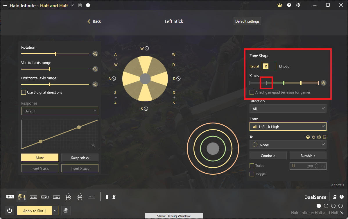

        Hello! I can suggest you raise the dead zone in advanced stick settings.
        Right there:
        Also, I can suggest you test your controller behavior without config here: https://gamepad-tester.com | and here with config: https://keyboard-test.space
            Right there:
