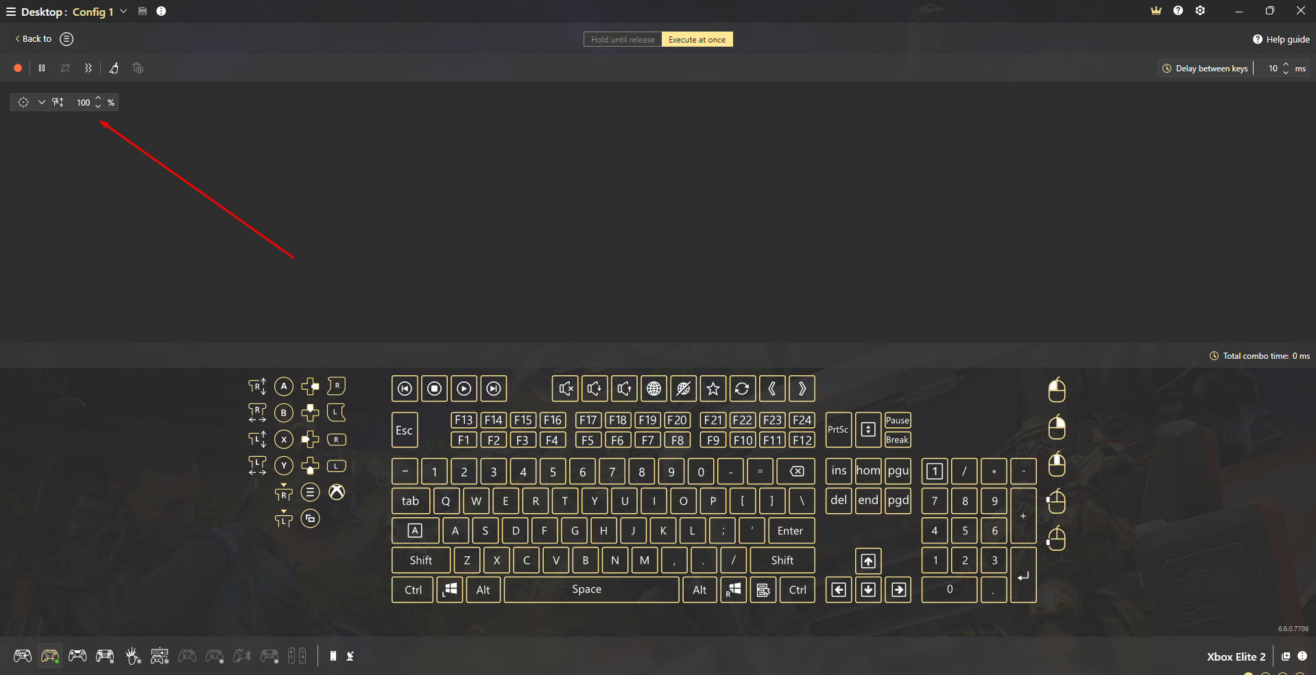

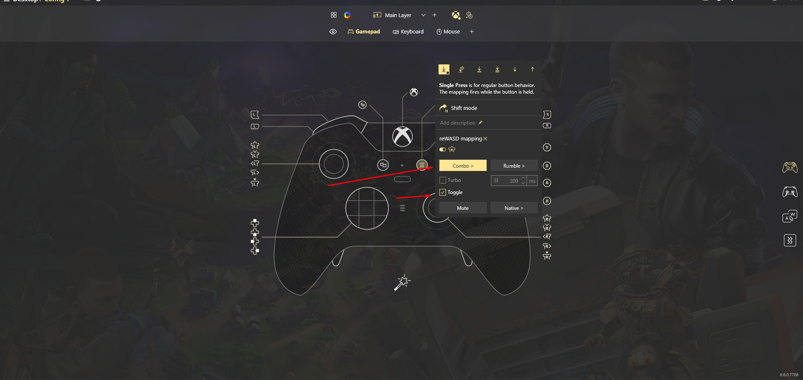

    If we are talking about holding the right stick forward. You can map a simple como to the Xbox controller button. Then, loop your combo using Toggle feature, so once you click a remapped button, the configuration will continue to input the right stick forward.
    Check my screenshots for the details

    I suggest checking this article to figure out how to add needed moves to the combo.​​

      Hey Miron, thanks for looking into this and for the suggestion. While this works for auto inputting the RStick forward, this doesn't really accomplish what I am trying to do, see my last two sub bullets in the original post.
      If what I am requesting is not possible, do you have any recommendations on how I can accomplish auto-inputting any direction for RStick?
        As I understand, your request is impossible to achieve in reWASD right now. As a recommendation can suggest making a shift layer with a certain number of combos in it, each of which is responsible for its own direction.
