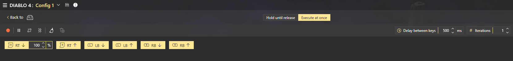

    For the first case, you need something like this:

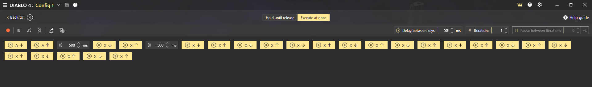

    As for the second, something like this, if I understand you correctly:

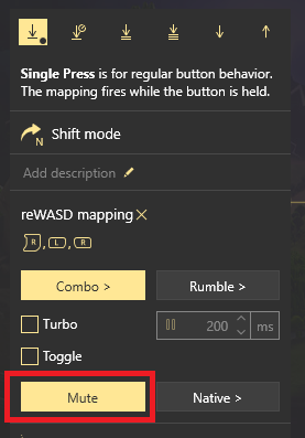

    Also, don't forget to mute the native input of both buttons here:

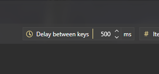

    Pay attention to this value in both cases:
