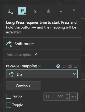

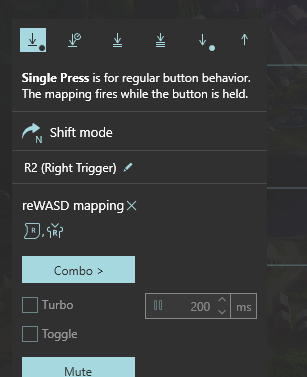

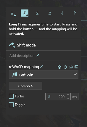

    Hi everyone,
    Ive found few older topics like that, but in all od them, devs wrote it is impossible and it wont work.
    BUT... i can swear it worked for me before last update (6.6). And now it stopped... or maybe i broke something.
    Why i need that double combo? In first combo, witch is set on SINGLE PRESS event i had basic fire and some no recoil.
    On second combo wich i setup on START PRESS event i had 1.5 sec pause and key to mark the enemies. Ive tried also LONG PRESS (1.5) and then key to mark...
    It worked like a charm, but now sudenly stopped. If two "events" are set non of them working anymore...
    Any idea how to fix it? maybe something in a application config?

    If I understand you correctly, when you hold down the fire button, you have an anti-recoil combo, and after a few milliseconds, pressing the d-pad up.
    We checked your combo in the tester, and everything works correctly (the input from the d-pad can be seen by changing the values in the tester).
    Please check it from your side in the tester: https://gamepad-tester.com/
    If this does not work for you, please send us your config.​
    We need the correspondent *.rewasd file.
