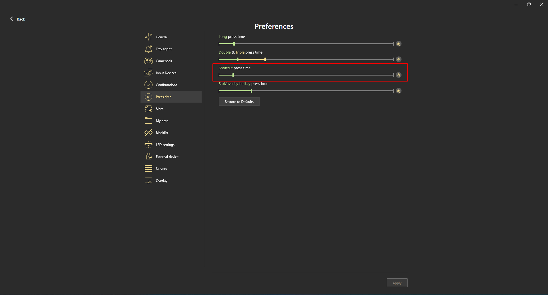

            As an option, try to adjust the shortcut press time using this slider. Probably, this is key to fixing the issue

            Try to set up different values. ​
              Thanks for the advice! I gave it a few experiments, but unfortunately this only seems to delay the pressing of all buttons.
