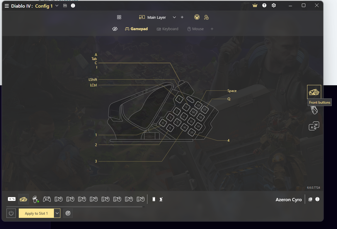

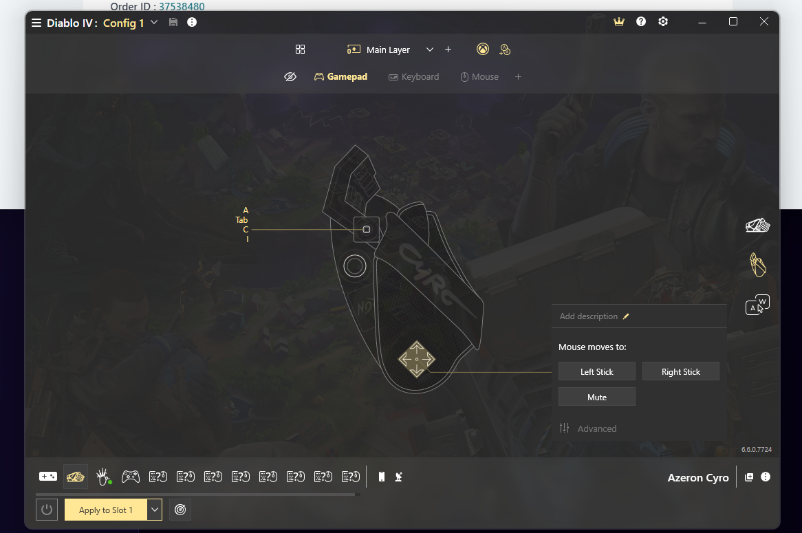

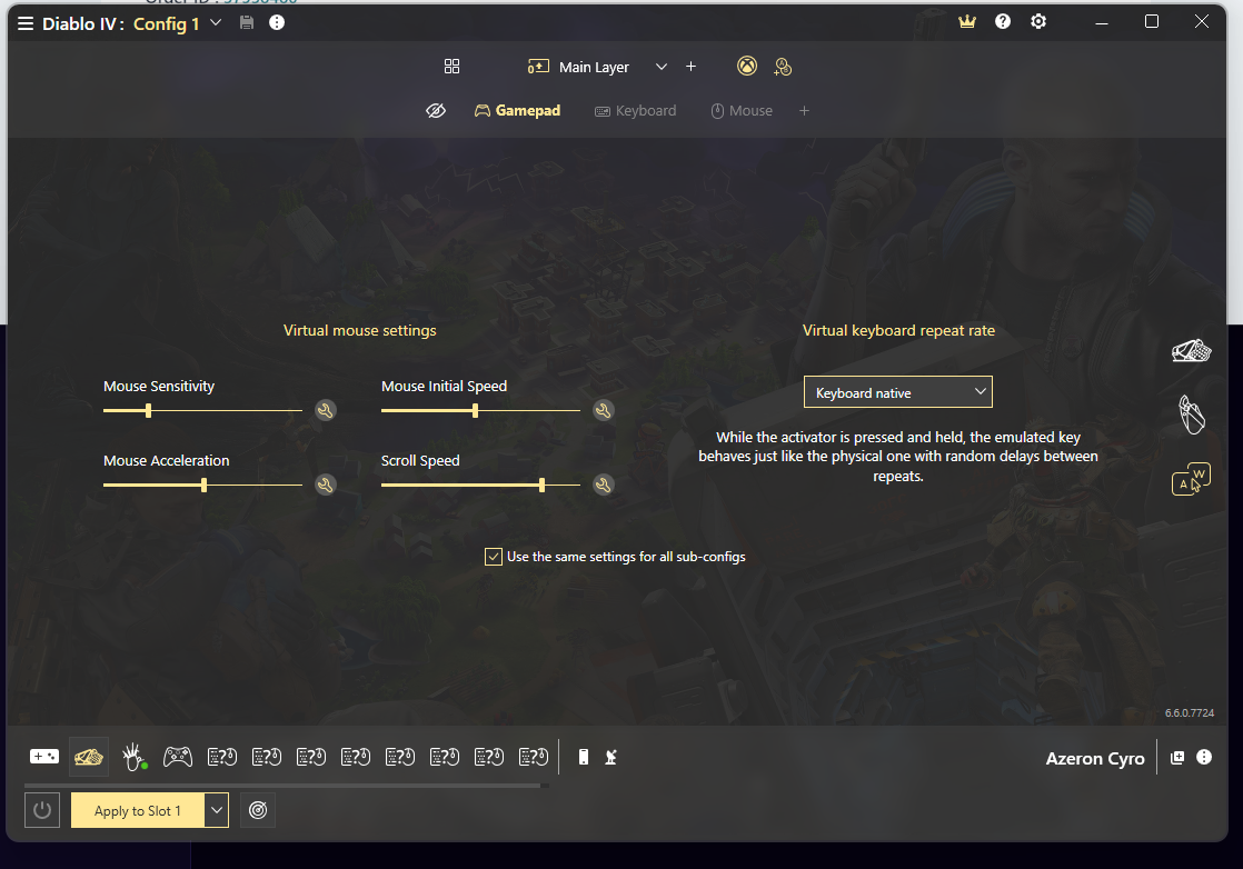

    Hi. Please send us a screenshot of the full reWASD window with your mouse mappings.
      What do you mean? you cannot go into "Mouse settings". There is not option.
ID:	238006​Click image for larger version
ID:	238007​As you can see, Keyboard/Mouse are greyed out.
          You need to group your devices before remapping and applying the config.
