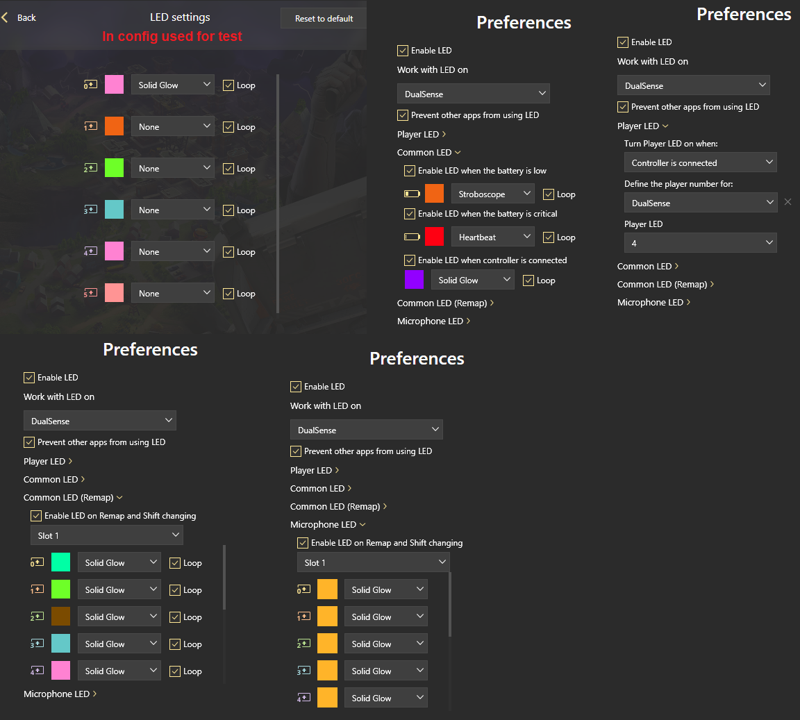

      I can't think of anything that would be interfering, so I'm assuming that I just have things misconfigured. Can you share your App Settings setup with me so I can replicate them? I am specifically using the Dualsense Edge in this case, so maybe there's some implementation difference there...
        In the profile settings, you configure the LEDs for the enabled remap state (for all Shift layers). And these LED settings overwrite the settings for the remap and layers from .
          A: I will attach my settings, but they are pretty ordinary.
          Maybe LED doesn't work correctly because you have exactly Dualsense EDGE, but I don't have any proof of that(I use ordinary Dualsense).
