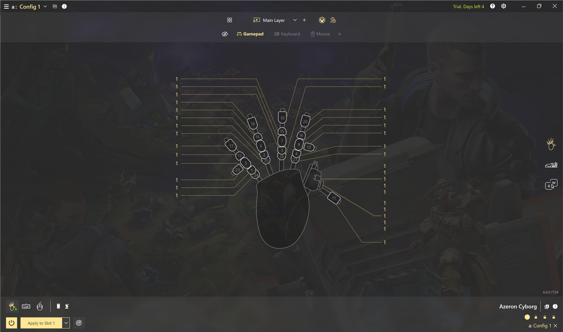

              Thank you for your help guys, I really appreciate your time:
              My mappings are literally all inputs changed to "1" just as a test until I can get the device working (attached just in case it's relevant).
              Config is default (also attached). The only change I've made is the general setting "hook controller buttons" set to "off" as per Azeron's guide.

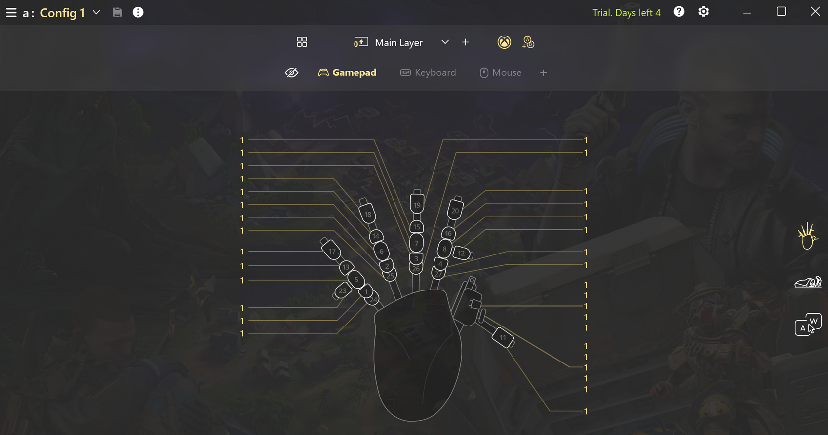

                You sent a screenshot of an incomplete window; please send us a screenshot of the full reWASD window.
                  Apologies!
