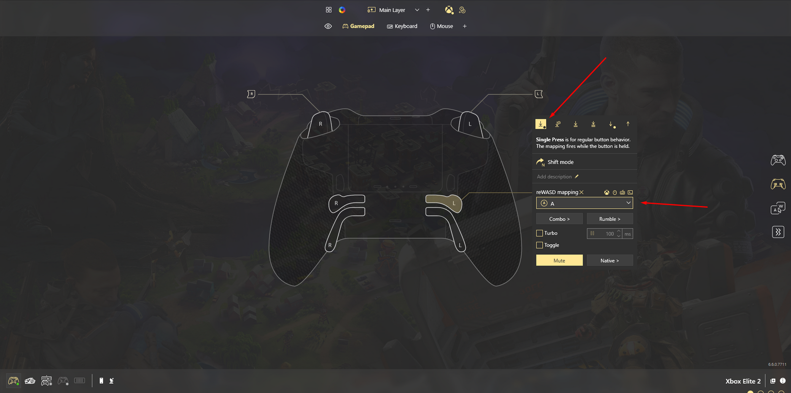

    You can achieve this using Activators
    Assign to C button as Single press

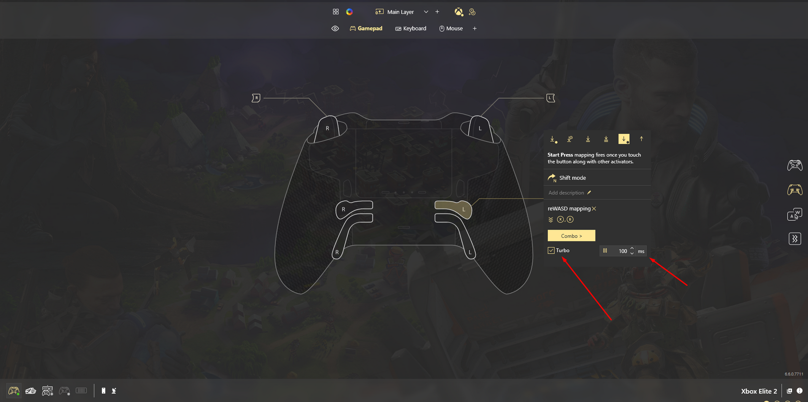

    Then, assign combo as Start Press and loop the combo using Turbo. The pause is adjustable in the Turbo field Click image for larger version
    So, while you hold a back button, will be pressed, and will be repeating
