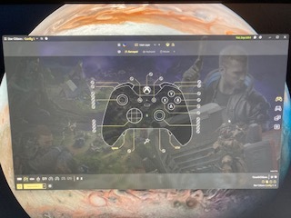

    I tried playing with the mute function (see attachment) - but I think I'm probably just not understanding something or this is not the correct way to do what I want.

    Unfortunately, your screenshot is too small to say what your issue is.
    But it looks like you have muted all buttons, which is why they don't work. Click the [Magic Wand] and uncheck the [Mute all] option. Just in case, uncheck any other option that might be enabled in that menu.
      Yeah in the pic I was trying to mute all to see if I could regain controller function while REWASD was active.
      Is there a way to disable REWASD having an effect on all my controller buttons except the back buttons (so I can continue to use my in-game control map with REWASD active?
      Prior to this, I tried setting everything to the default (so A as A, Thumb sticks as Thumb etc) but that just had the same effect in-game where nothing worked except the back buttons when active.

          I tried setting it to a virtual Xbox One controller with the magic wand option (with the back buttons mapped to keyboard functions too) but still, no inputs registered in-game while active (only the back buttons that I have mapped to the keyboard).
