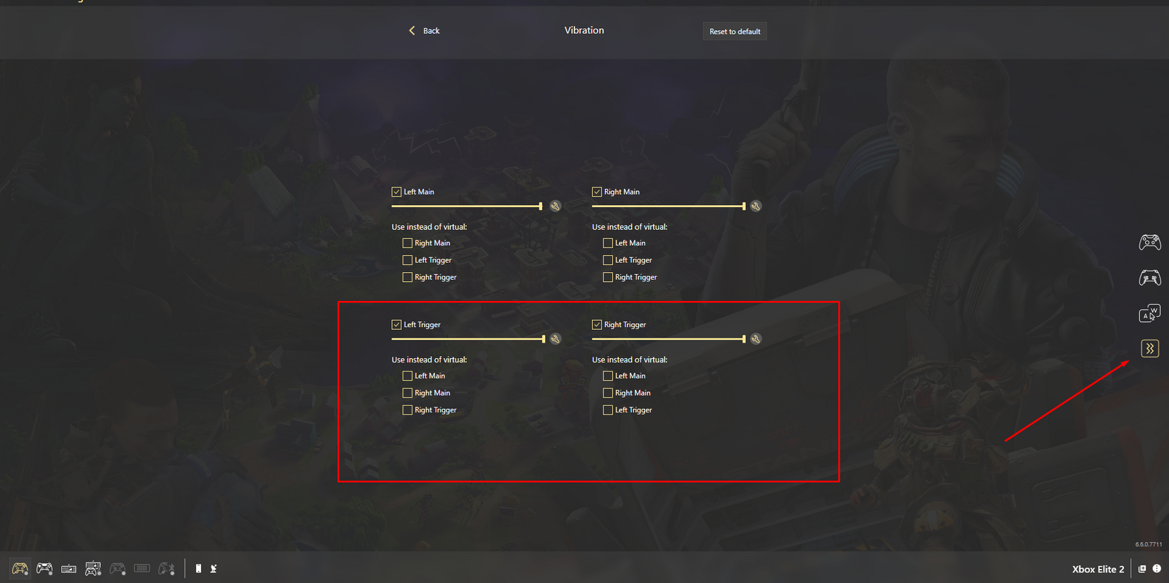

    I assume that you have Xbox controller, so have you tried to adjust the values in this tab?
    You can reduce/increase both triggers.
    Or is the problem more deeply rooted?​
      More deeply rooted since once you click "Use istead of virtual" the slider does absolutely nothing ./:
