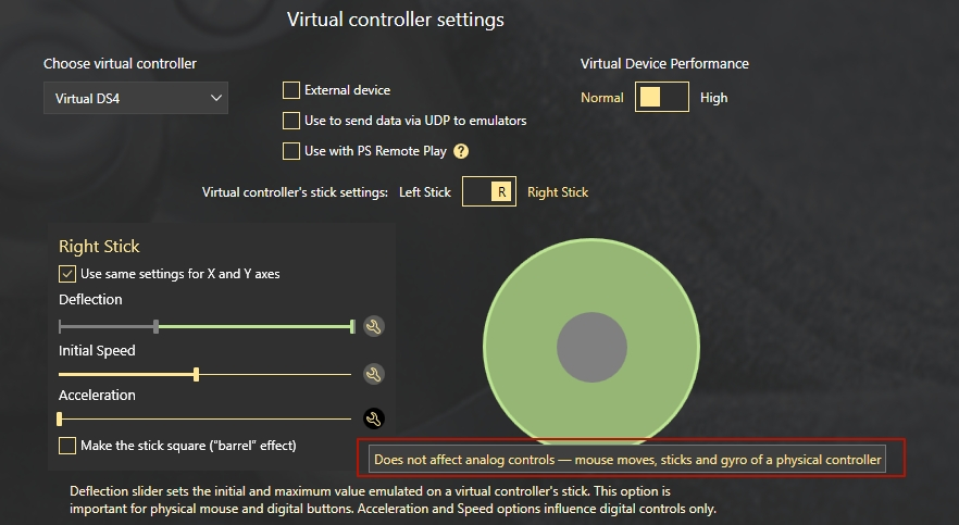

      I use it now and when I want to make my left stick Faster as possible on x I don’t feel anything happened When I changed the y,x acceleration on console
      Idk what’s wrong
        If you hover over the acceleration settings icon in the virtual controller settings section, you will see the following hint:
        Therefore, if you want to change the behavior of your physical stick (if you are physically using a gamepad), then you should change the response curve in Advanced stick settings.
