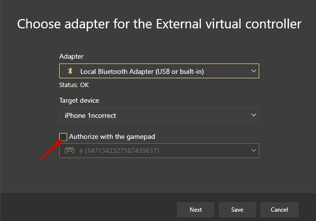

                  rajpatel32 In order for the external virtual controller to be detected correctly by games on the target PC, do not enable this checkbox when creating this reWASD controller:
                  P.S. In my example, creating an external controller via a BT adapter, since there was no GIMX at hand.​
