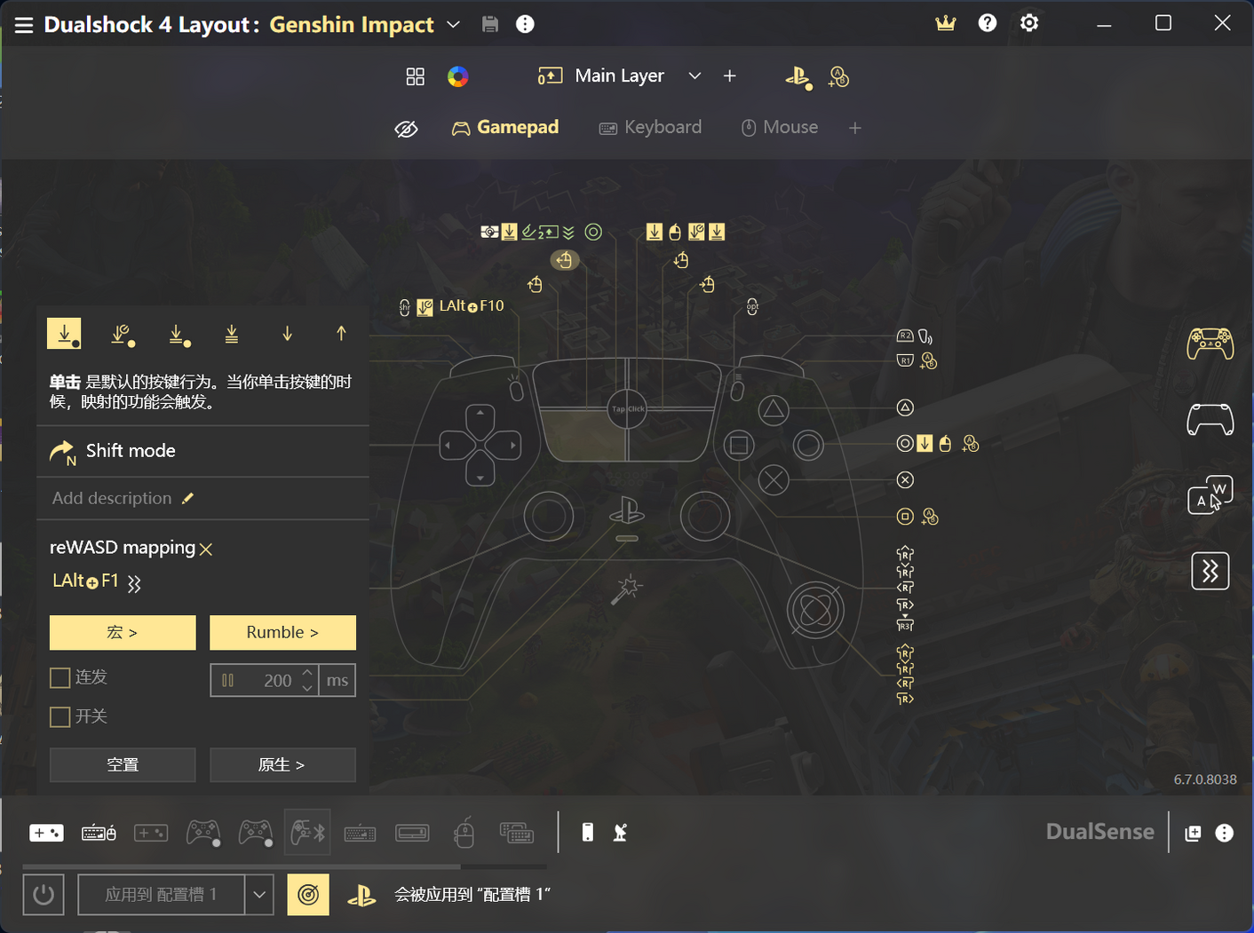

      This is my key mapping configuration. I turned Alt+F1 into a macro and assigned it to a single click, and I added a vibration for confirmation.
      I found that mapping for single keys can take effect, except for macros. At the same time, I can confirm that this macro, when placed on a double-click, functions properly when held down.

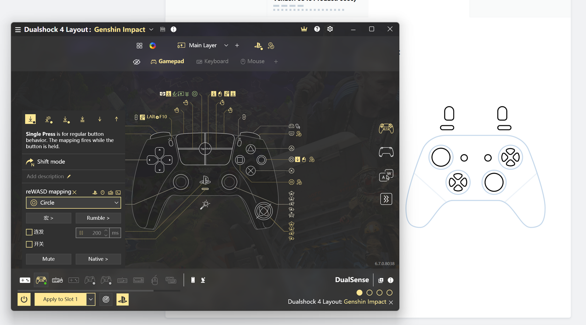

          The test is consistent with the situation I reported.
          When I map it to the 'O' key, every time I press the microphone key, the corresponding button on the test page will flicker.

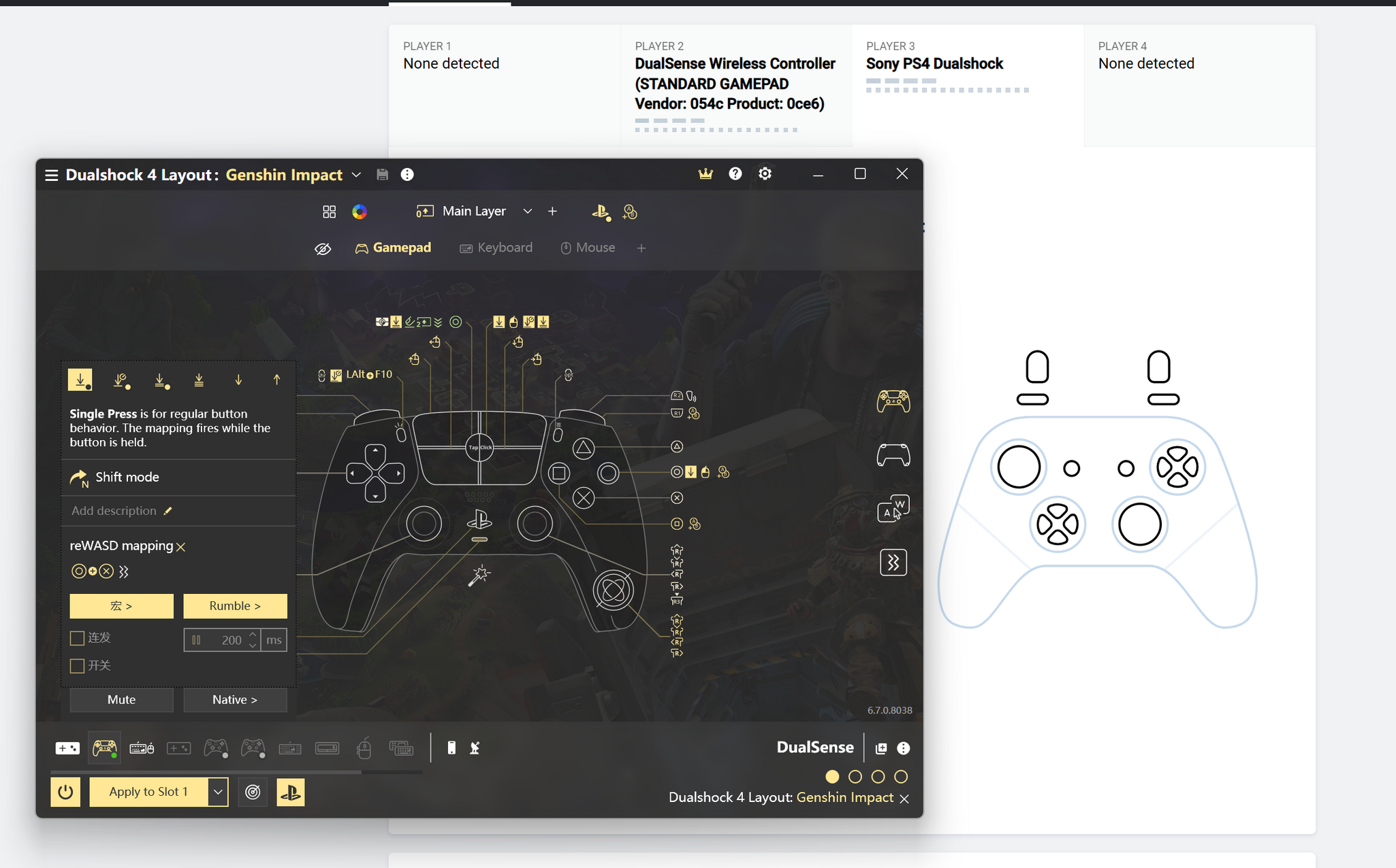

          When I map a macro, regardless of what it is, the buttons on the test page do not respond at all.
          Even if I map a single 'O' key as a macro, the corresponding 'O' key on the test page still does not respond.

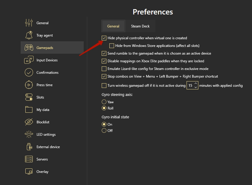

                Before I pass the logs to the team, I would like to clarify one thing.
                Do you have this option enabled?​

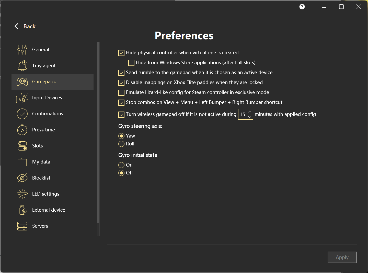

                  Yes, most of them are default settings.

                    As we can see from your screenshot, the tester shows one more controller besides our virtual one; it shouldn't be like that.
                    Please make sure that there are no third-party remap programs on your PC.​
                    Also, please ensure that controller support is turned off in the Steam controller settings.​
                      Ahh! It's my fault.
                      Turned off Steam and it worked again.​
