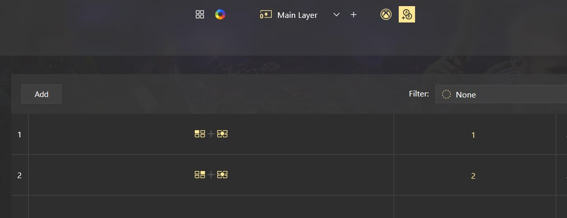

    If we understand you correctly and you want to assign mappings to the 4 corners of your touchpad, then this can only be done using shortcuts.
    Add a tap on the desired part of the touchpad + click, and select which mapping you want to apply.

      Thanks, I'll try that
