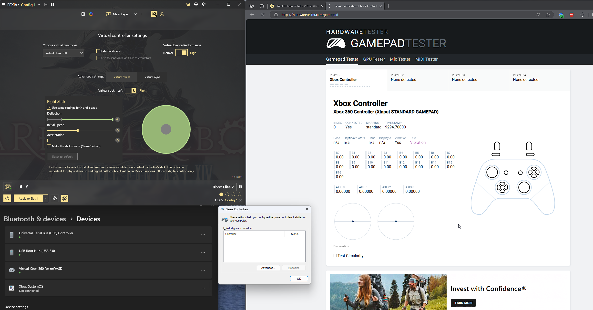

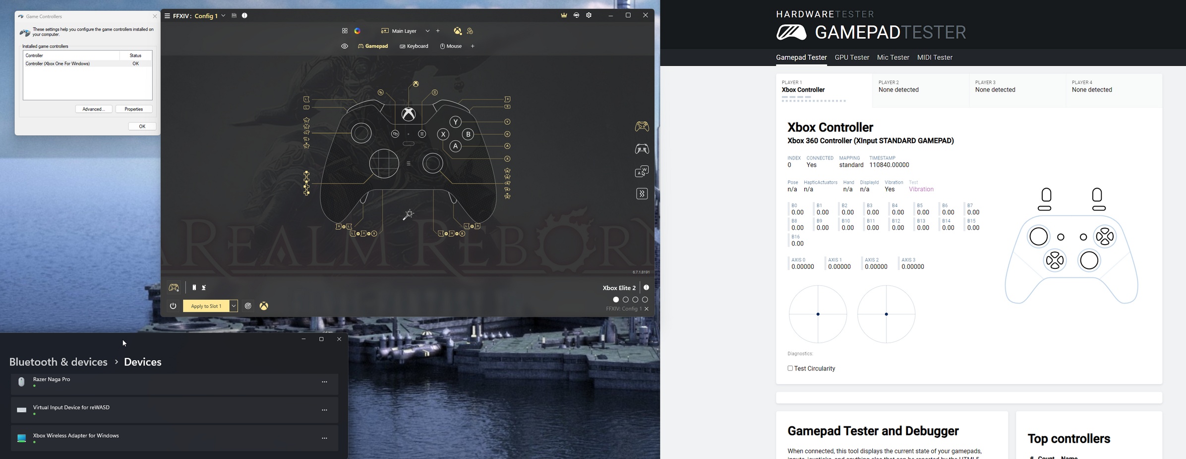

    Screenshots below:
    reWASD On: Here we can see the mappings activated on reWASD, joy.cpl being blank, "Virtual Input Device for reWASD" on Win11s Devices and Printers Screen, GamePad Tester successful test.

    reWASD OFF: Here we can see the mappings deactivated on reWASD, joy.cpl & Win11's Devices and Printers Screen showing the Xbox One Controller, GamePad Tester successful test.

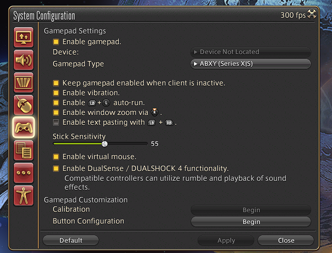

    With reWASD On, unfortunately FFXIV does not see the controller (since it relies on joy.cpl):

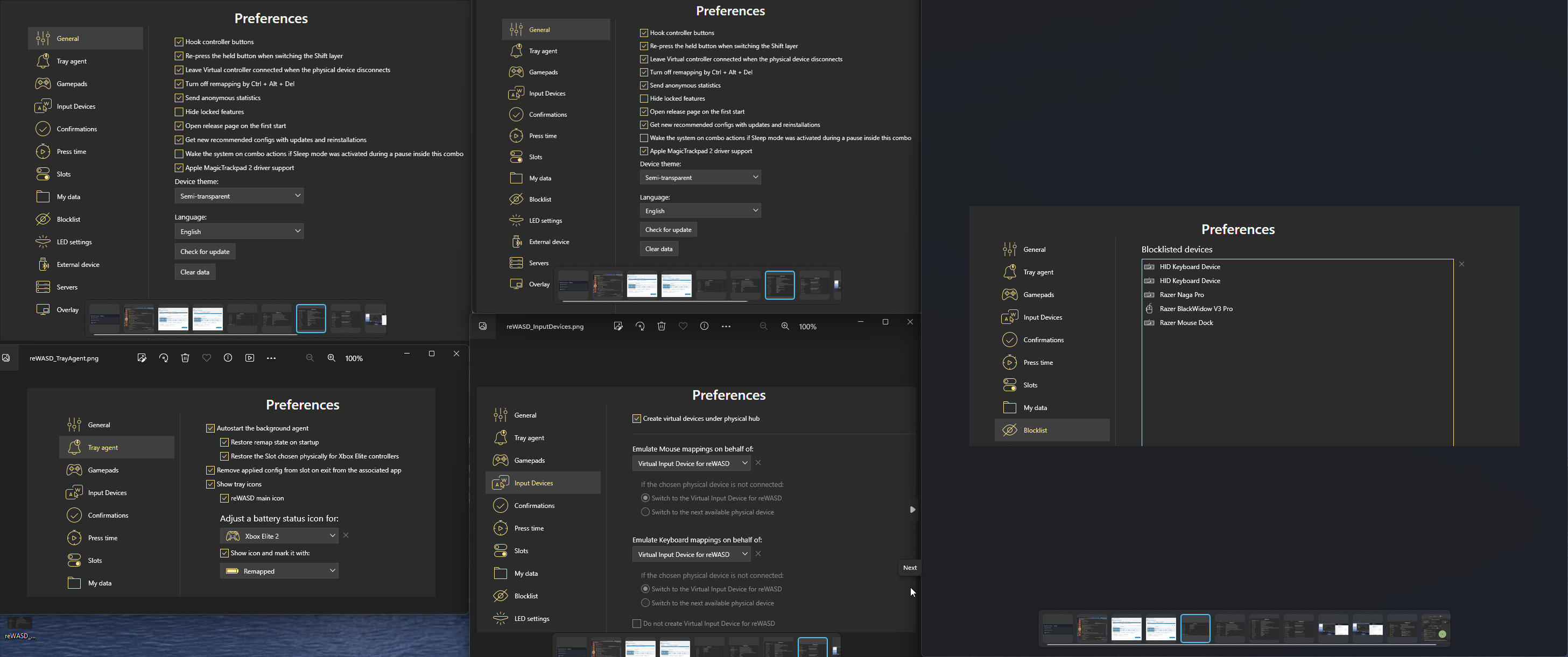

    Some screenshots from my configuration below:
    Several screenshots of settings in reWASD

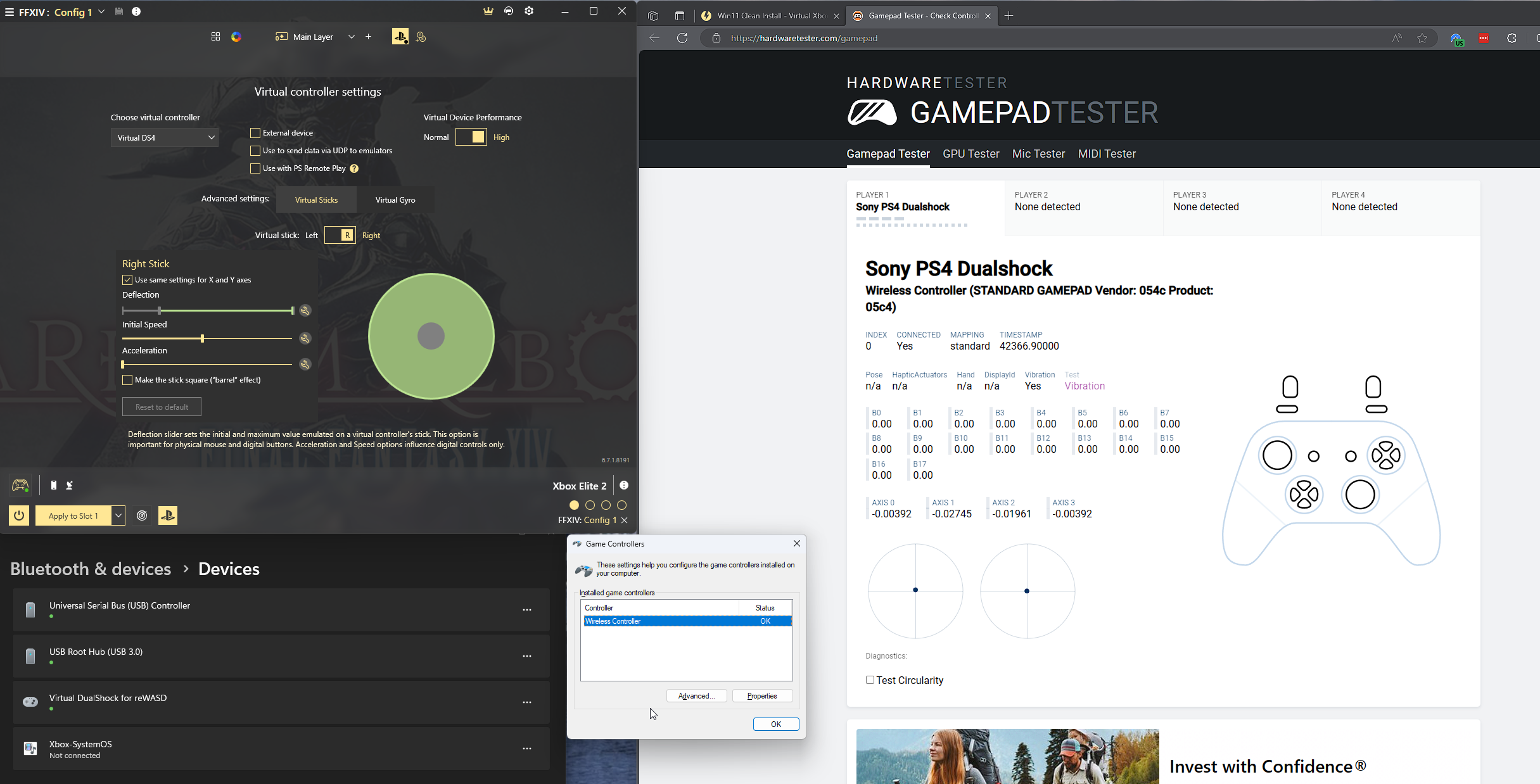

            I've tried all Virtual Controllers. There's mixed success here:
            • Virtual Xbox 360: No joy.cpl entry / Success in Gamepad Tester [Same as Virtual Xbox One] / Entry in Devices & Printers "Virtual Xbox One for reWASD".
            • Virtual Xbox One: No joy.cpl entry / Success in Gamepad Tester / Entry in Devices & Printers "Virtual Xbox One for reWASD".
            • Virtual DS4: Joy.cpl Entry!!! "Wireless Controller" / Success in Gamepad Tester / Entry in Devices & Printers "Virtual DualShock for reWASD".
            • Virtual DS3: No joy.cpl entry / Success in Gamepad Tester [Same as Virtual Xbox One] / Entry in Devices & Printers "Virtual DualShock for reWASD".
            • Virtual Switch Pro: No joy.cpl entry / Success in Gamepad Tester [Same as Virtual Xbox One] / Entry in Devices & Printers "Virtual Switch Pro for reWASD".
            Question from my side: Is there a command in terminal I can execute to force a driver uninstall/reinstall? (I use at work devcon a lot for this type of issues, so if you point me to where the driver infs are, I can problably try force an inf uninstall/reinstall.)
            Some screenshots below.

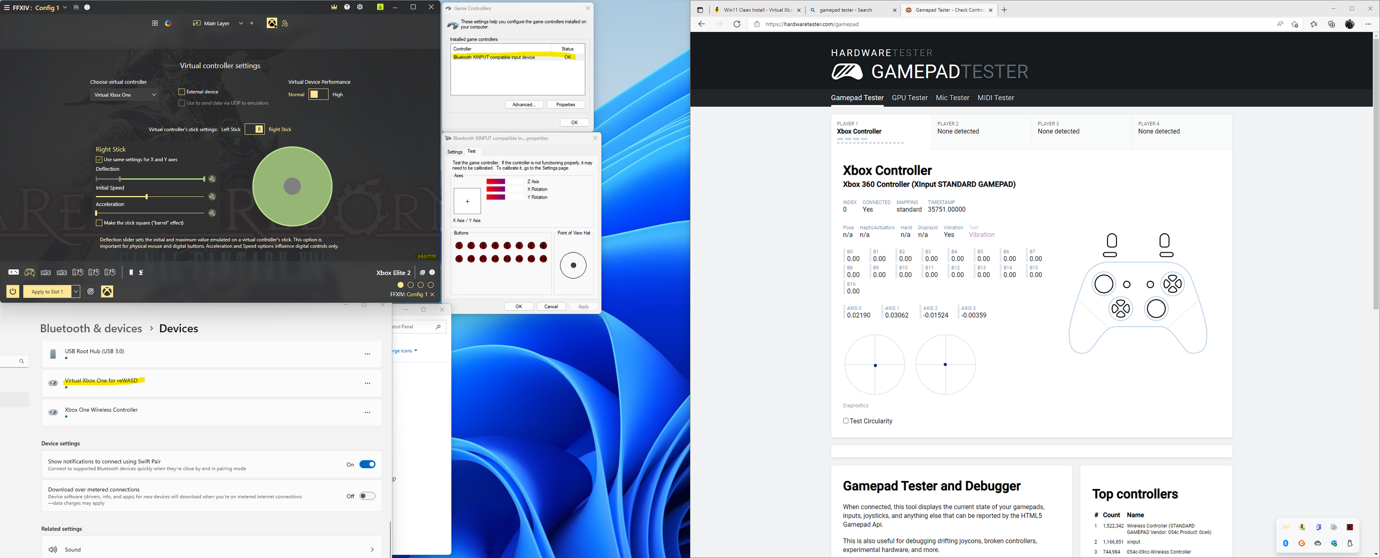

              reWASD 6.6.0.7770 - Successfully Fixed
              Caption
