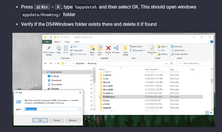

          I wonder what that third party could be. The only other remapping software I use is Razer Synapse, but that's only for my mouse. To my knowledge I have nothing else that involves gaming open other than Battle.net. Steam is definitely closed and I checked for a DS4Windows install at the below location, but there was nothing to remove.
