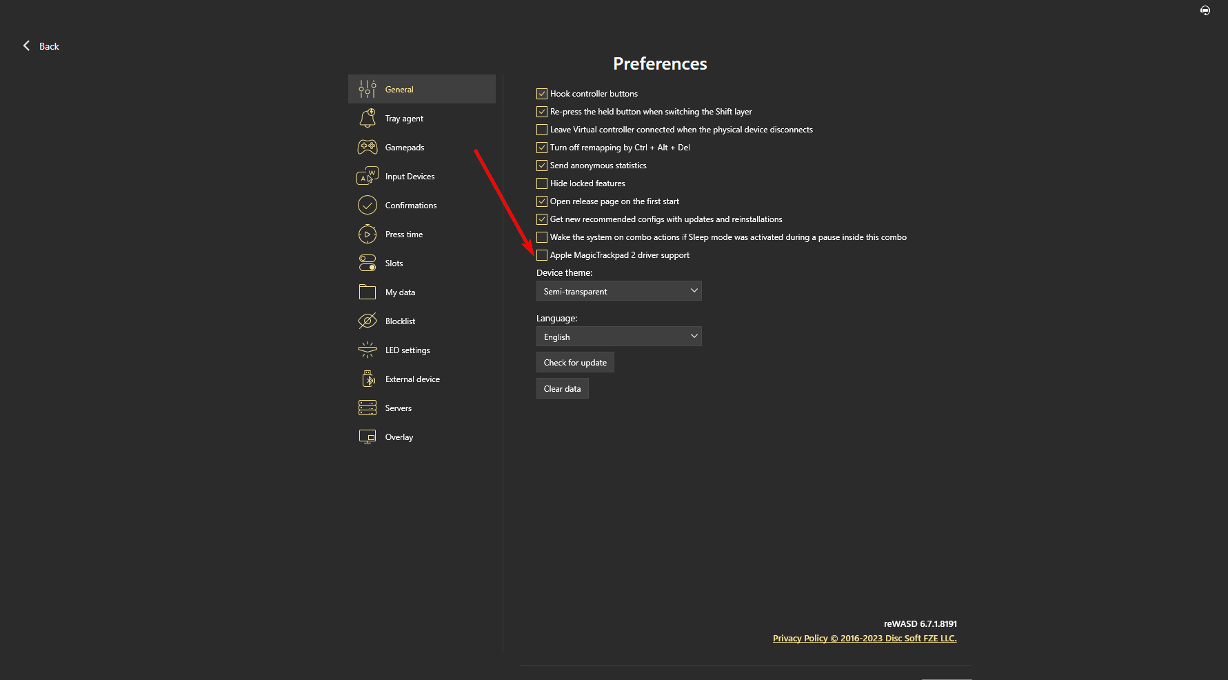

    Please disable this option in reWASD preferences and check if the issue still persists
      I tried and currently it seems to work. What dosen`t have to mean a lot. A day bevore it worked for a while and than today the same trouble. I`ll update if that really consistencly fixes the problem. One thing I noticed ts that it now shows the buttons when pressed in the Layout. It didnt before- So maybe disabeling this Option did something. Thanks n advance. That`s a really Headache for the last couple days!
        Update: After testing for a while now, everything seems to work. No random disconnects anymore. Seems deactivating this Option did the Trick.I don`t know why, but I`m glad that everything is back to normal and hopefully stays that way. Thanks a ot for the help. Appreciate it. I really like ReWASD. It`s such a great and comfortable Mappingtool, but that Issue was driving me crazy. I`m really happpy that issue could be fixed!
