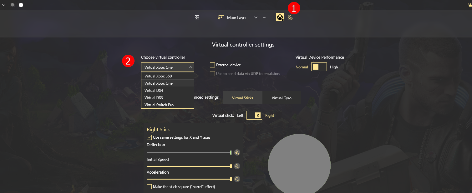

                I can't say for sure.. However, it is better to check how all virtual controllers work. Please go to Virtual Controller settings and check if this issue still persists.

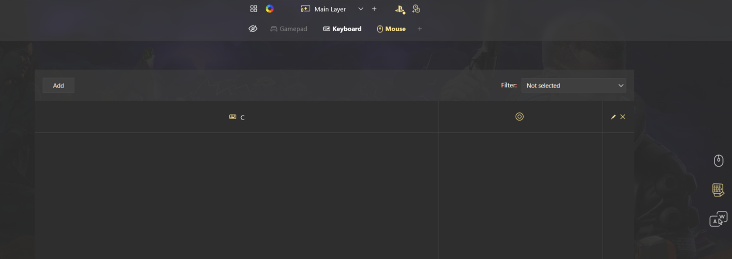

                  Thnak you for reminding me the tester usage!
                  This helped me to identify the issue much easier than testing in game.
                  Initiatly when I read the Remapping a mouse with programmable buttons I just screend the ​steps, and as I just took a profile from the comunity, I did not actualy map again the buttons.
                  I had the impressio that if I have C mapped on my keyboard and C mapped in the Mouse software will work .. but it seems I need to map again C in REWASD on the mouse interface.
                  Seems to be working now ... I just need to remap all!
