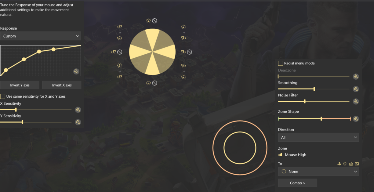

    2. In the profile I am using, there is a different Shift for Aiming (ZoomIn) vs Hip Fire.
    It seems it has a different sensibility (posted below):
    However, when Aiming is very hard to move the mouse horizontaly on target, as it "stops" before moving on top of the target.
    Also on some cases the same happens verticaly ... you practicaly cant lower the cursor, so you shoot above the target.
    Any sugestions ?
    PS: I read the Mouse Advanced Setting, but not sure how all fit in practice .. mouse High Zone, mapping on High Zone (used when/why ?), noize etc. A practical example would be great!

      2. Fair .. maybe a few (slightly) targeted questions:
      - Zone Shape: What are the 2 circles representing ? I can change the smaller one ... to what point ? Is a portion of the screen ?
      - Smoothing and noise filter .. I understand the explanation technically, but not sure the usage ... how will those make sense as a starting point for the Hip-Fire respectively Zoomed/AimedFire ? What a general rule ?
      - Direction & To .. I see they have a default ... here I don't understand the potential usage .. any example ?
      Thank you!

        2. On your screenshots, the X-axis sensitivity is slightly lower than the Y-axis sensitivity. Setting the same values for both might help.
          Zone Shape:
          It is technically the speed of your mouse. Unfortunately, I don't have a formula to convert zone values to actual speed.
          Smoothing/Noise filter:
          I don't understand the question. The first one does not move the stick instantly and applies "inertia" instead. The second ignores small mouse movements.
          Direction:
          Zones can be remapped to almost everything. While the remapped value is within the Zone, the mapping will be "held". This feature is more useful to sticks than a mouse. For example, let's say you are playing some MMORPG game that needs you to hold [RMB] to turn the camera around. In this case, you would maximize the High zone and remap it to [RMB]. As a result, [RMB] will be held on any mouse movement.

          A few more stupid questions:
          Zone: is more clear now … but what is that circle and what does it do is smaller/bigger ?
          noise/Smooth … clear … when would you want to ignore mouse movements .
          Direction: the concept of a zone … being remapped is confusing … you just said a zone is .. the sensibility … now mapping this is a concept that is hard to grasp
          thank you!
            Zone Circles make sense for stick mappings and don't mean much for mouse-to-stick mappings. I suggest ignoring them.
            Mouse Zones are technically a speed range. Direction is a direction where you move the mouse. So, if you remap the Up direction of a High Zone, you will trigger that mapping only when you move your mouse up fast enough to reach the High Zone.
              Thnak you!
              So practical no use for the zone if I want mouse-controller mapping.
              Also the Aimed setting were practicaly done by the author to lower the mouse sensitivity when Aimed (as some games have this in settings).
              I assume I need to play with those to fit my Screen size, General Mouse sensitivity, depends on FOV maybe ?, even gun zoom gun etc.

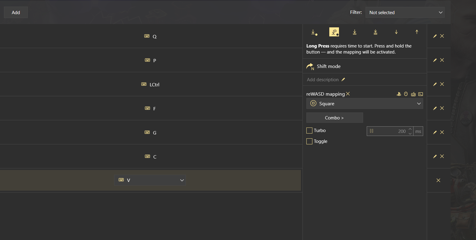

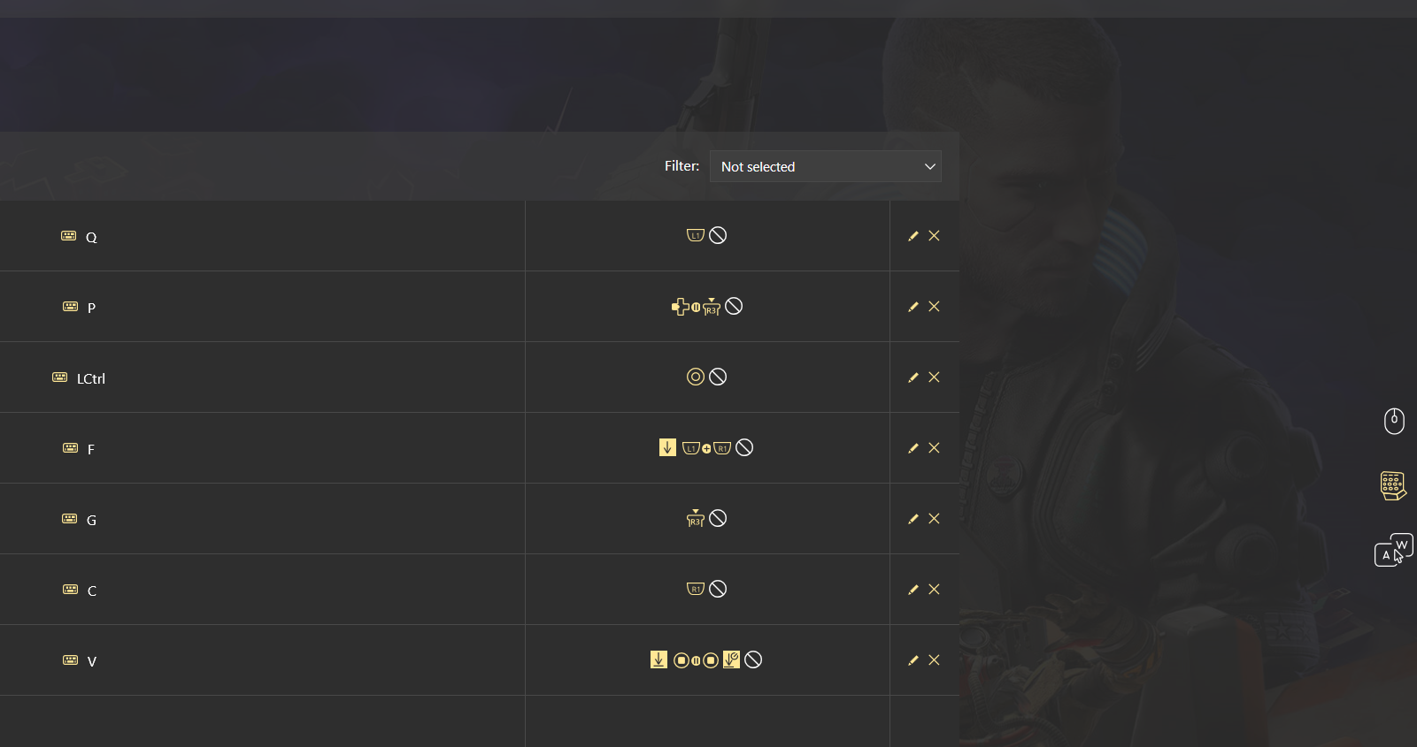

                Seems the Mouse -> V -> SQ mapprting does not work for me (neither hold nor long press).
                So I am doing smth wrong
                Do you spot anything ?

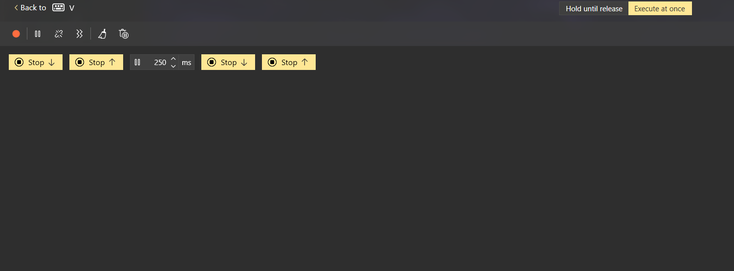

                      Unfortunately, the mapping that you mentioned is not in the config that you sent us.
                      Also, in your screenshots, you show completely different mappings.
                      If you need a [square] button, then you need to select it from the controller mappings. In your screenshot, you have selected the [STOP] mapping from the keyboard keys instead of the [square] button mapping.​​
                        Ah lol on the Stop . I fixed now.
                        The V mapping is in the mouse button mapping, not on keayboard. I am reataching it with the Stop fixed and another small fix, however still does not work
                        PS:When I press the Mouse (V) button, it reloads the weapon, as the SQ is also Reload when single press.
                          Solved.
                          Well .. It seems that on controller I need double/long on o not SQ ...
