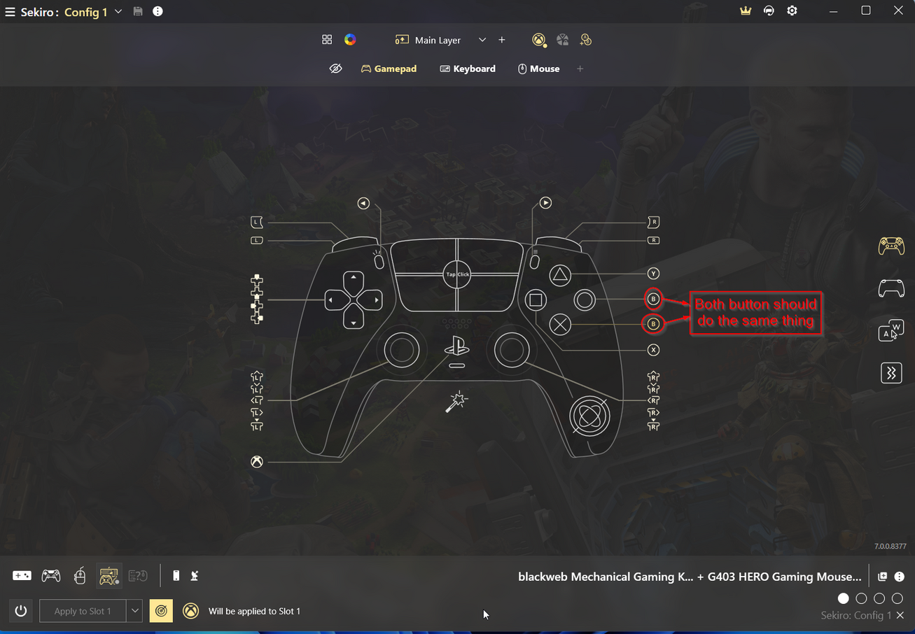

    I've been using rewasd to add missing control features to PC games for years and love it.
    Despite all this time, I have a new problem that I've never had before.
    I bought Sekiro on steam today and when I change the key mapping on my dualsense, the changes are not taken into account by the game.
    It seems that the game uses the physical controller and the Xbox 360 virtual controller is ignored. Note that key assignment changes on the keyboard are taken into account by the game.

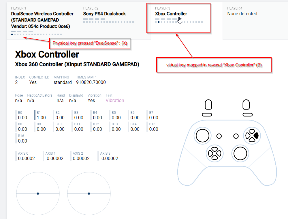

    Please apply the config manually and check if it works correctly in the tester: https://hardwaretester.com/gamepad
    If everything works correctly in the tester, please try to apply the config manually and check if everything works in the game.

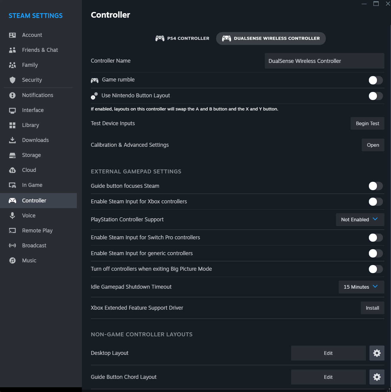

    Also, try disabling controller support in the Steam controller settings.
      With the configuration applied manually, it works correctly in the tester but still the same in the game, only the physical dualSense is used.
      I deactivated the controller in steam, restarted the game, but with no effect.
