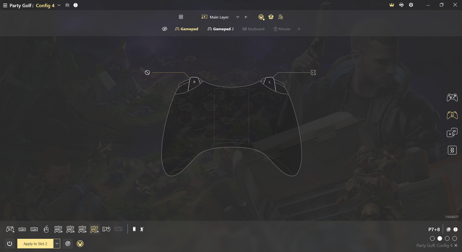

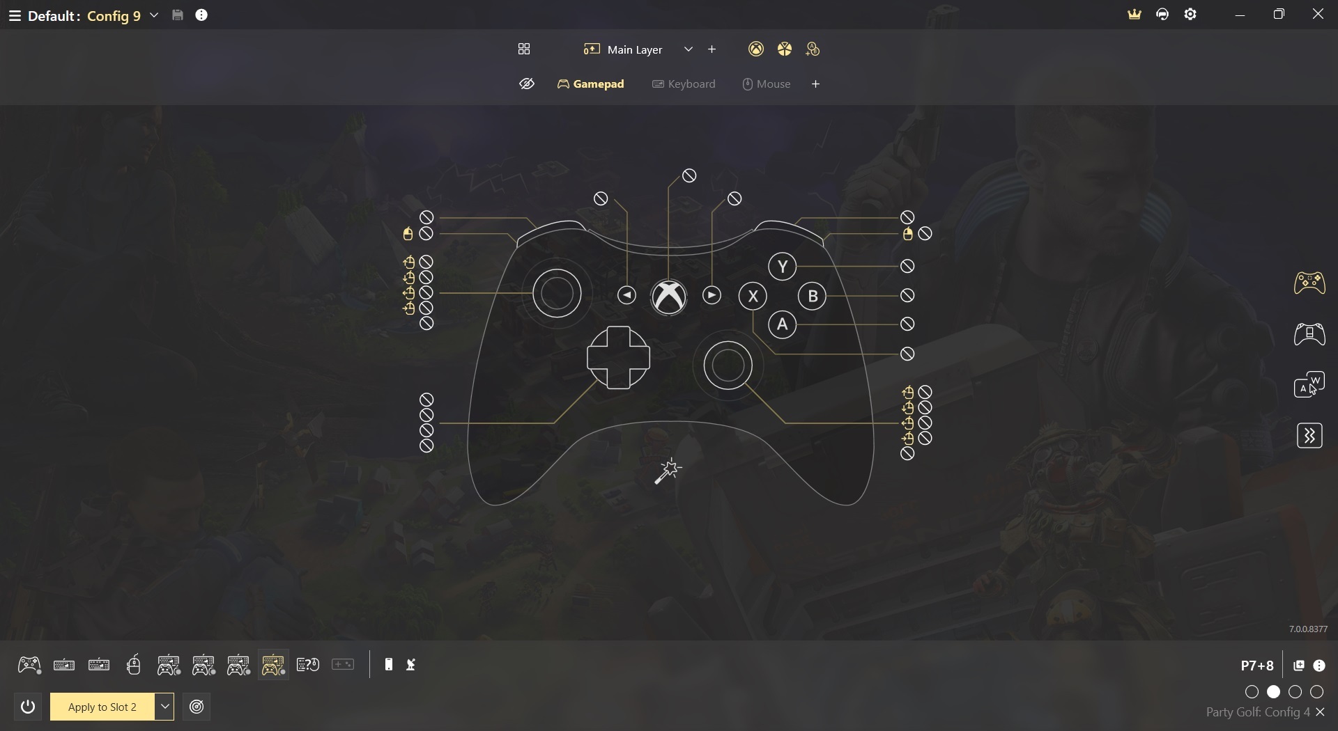

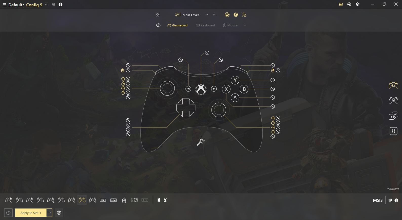

      I don't think I fully understand you unfortunately. I've attached 2 pictures of profiles that individually both work as intended. However, 1 profile makes use of grouped controllers and the other makes use of separate controllers (see the device panel in the pictures). The way it seems now I can not switch between these profiles without manually grouping or ungrouping the controllers each time.
      Is that correct or am I missing something?

        Sorry, disregard the first picture. I can't edit my post it seems. But see the picture below for what I actually mean.
          You cannot switch profiles for different groups of devices via reWASD (except the manual switch that you mentioned).
          You can use slots to switch configs using a custom shortcut. But this only works within one group of devices.​
