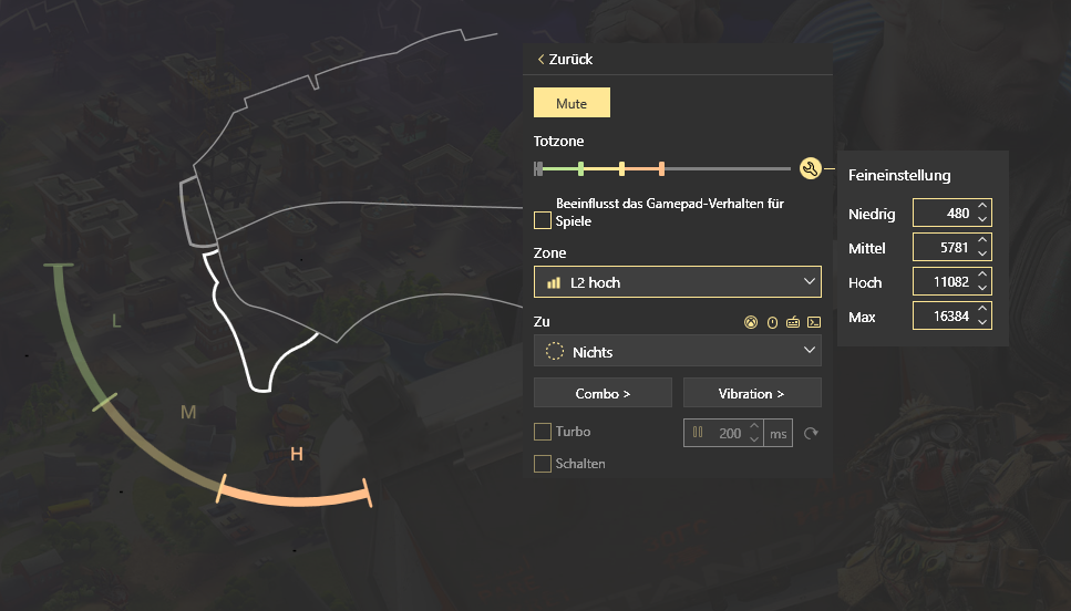

    So I've tried for myself to half-cut the standard values which reWASD offered me, which you can see in the picture below:
Name:	Desktop Screenshot 2023.12.25 - 11.05.08.52.png
    These settings acutaly made a bit of improvement, but doesn't appear as a 100% smooth-feeling solution.
