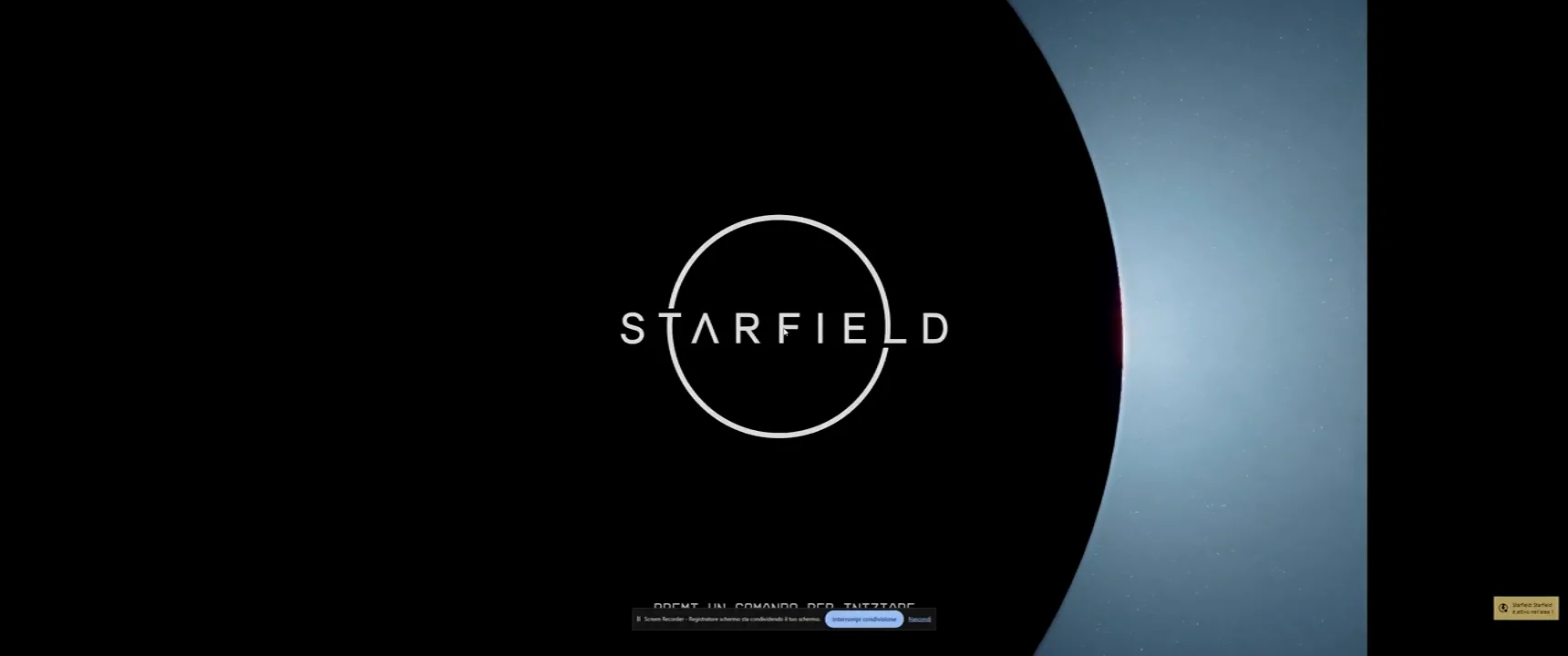

      Here is a screen capture: look at the overlay notifications on the bottom right, the profile/config change correctly until the end where slot 1 of default profile get lost.

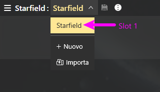

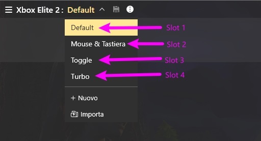

      Here details on both profiles I'm using for this example.
      Default profile, with 4 configurations, 1 per gamepad slot Game profile, with a single configuration on the first slot
