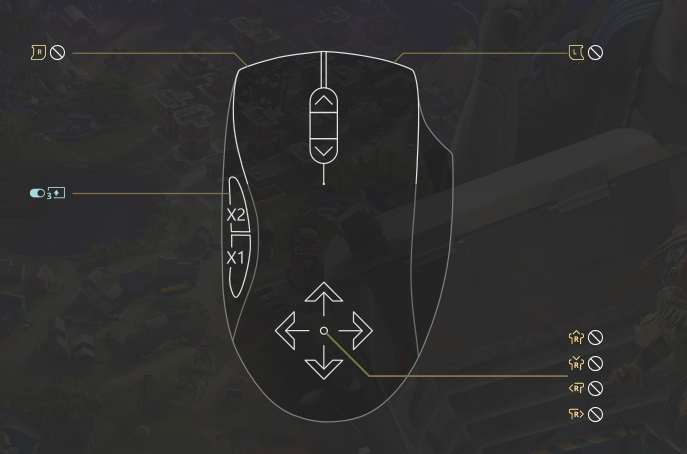

    Hey, I'm new to ReWASD and tried to use a config.
    In game the left/right and up is working good but the down meh...
    If I go VERY slowly I can aim down, if I go too fast it aims to the top really fast...
    So I thought it was a config issue and switched it but it wasn't the config fault.
    Here is a clip so you can see better what is happening : Click image for larger version

    Unfortunately, the video doesn't tell much without the Controller Tester Overlay.
    However, it could be the calibration issue. Apply the config, open the [joy.cpl] tool (type that into the Windows Start Menu), select our virtual controller, click "Properties", switch to the "Settings" tab, click the "Calibrate" button, and follow the Wizard instructions.
      Hi, thank you for your answer.
      The reason of this was that my controller was plugged in, after unplug, rewasd right stick on mouse was working correctly.
