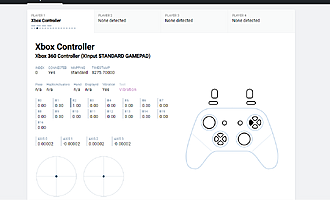

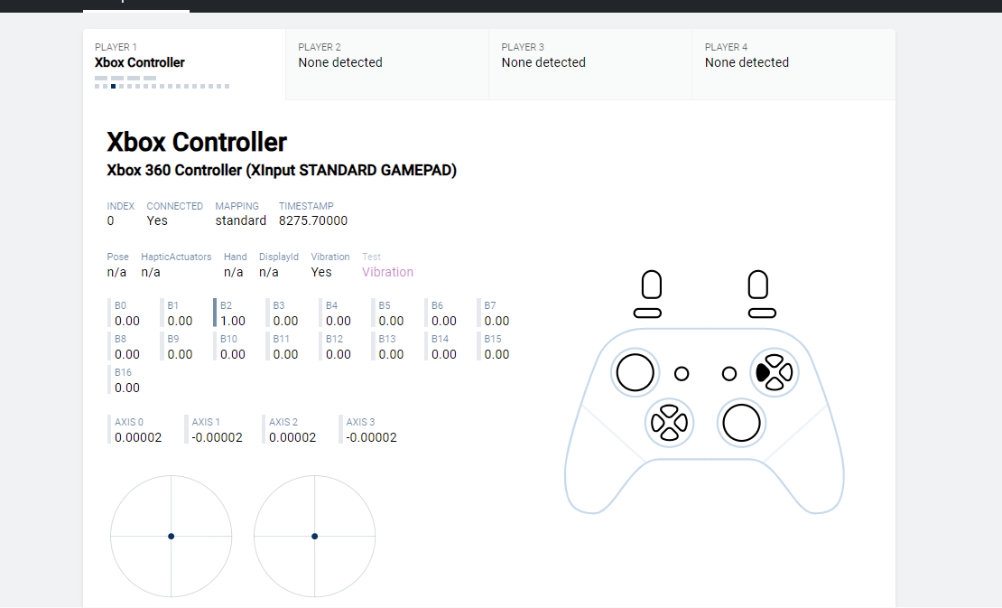

            I press the R button, and the tester catches the X controller input without issues.
