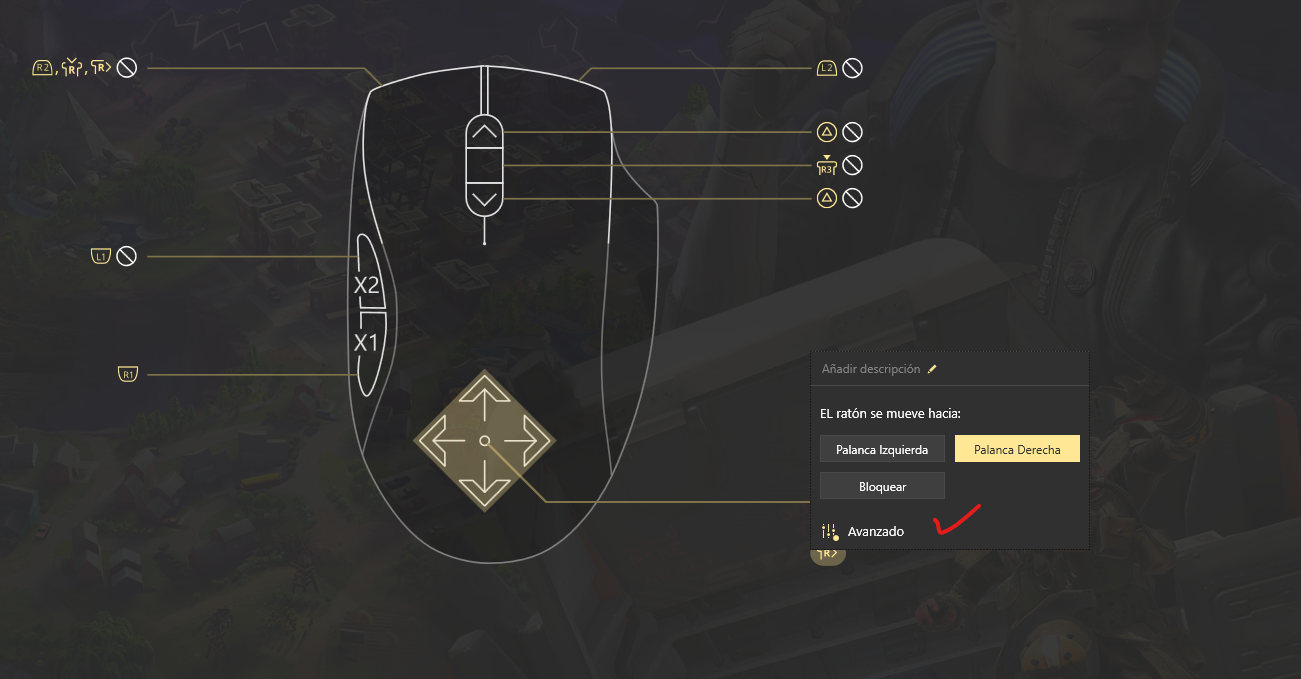

    Hola, nuevamente un problema relacionado al Mouse, todo funciona menos mover la camara
    Durante la versión de prueba funciono, compre el programa y dejo de funcionar.
    Anexo la configuración que tengo
    Gracias

    1. Make sure you have [Advanced mapping] feature, as it is required to remap mouse to a stick of our virtual controller.

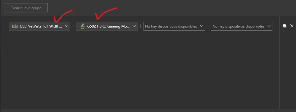

    2. If necessary, initialize your mouse and keyboard devices(pay attention to the device icon). You can use [Device detection] to know who is who if device names don't state that clearly (https://help.rewasd.com/interface/device-detection.html)
    3. Group up your keyboard and mouse devices. In case of problems check case #24 here: https://help.rewasd.com/faq/troubleshooting.html#24
    Also, don`t forget to apply Mute here:

      2. It is also correct

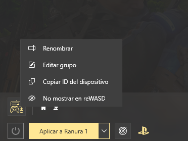

      3. Everything is fine but I don't get the "Re-Initialize" option

            • Your mouse mapping is not [Muted]. This will result in double inputs, which is not recommended for many reasons.

            • A group cannot be re-initialized. You have to disband it first.
