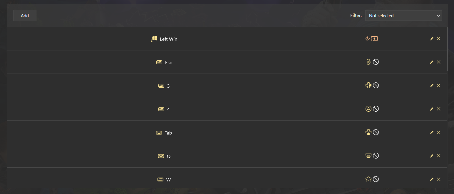

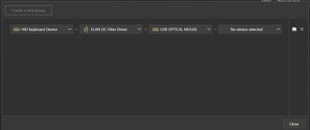

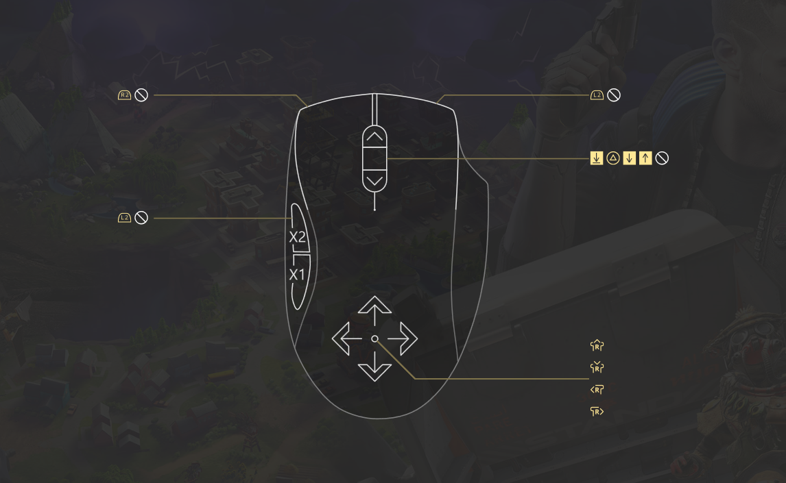

      The links are not working for me to know what you are needing me to provide. Is there a better link that would take me to a place where I can take the screenshots that you are looking for?
ID:	241107​I think this is what you're looking for.
ID:	241106​Click image for larger version
ID:	241108​If you need more screenshots, please let me know =]
          You need to apply the Mute feature to your mouse movements. Then apply the config and check if it works correctly in the tester.
          If everything is ok in the tester, then make sure that you have selected the correct input method in the game (from the controller).
            So, I am looking at the guide to mute the mouse, but do I need to mute all buttons on the mouse for the setting to work?
              To avoid lags and double input in the game, you need to mute all keyboard and mouse mappings in the main configuration layers.
                I have tried muting the mouse from main layer and starting it. Would not work.
                I then unmuted main layer mouse and muted shift layer 1 and it does not work either.

                  We missed one important thing:
                  In your group, the [USB Optical Mouse] is initialized as a keyboard. That's why it doesn't work as a controller in the game, because mappings are not applied to it.
                  Do the following:
                  2. Use Detection mode to find the correct Keyboard and Mouse. If you press the mouse button but see keyboard in reWASD, then you will need to re-initialize it (from the contextual menu of an active device).
                  3. After you are sure about all the devices, please group Mouse and Keyboard and try to Apply your config and test it in joy.cpl or in a game​
